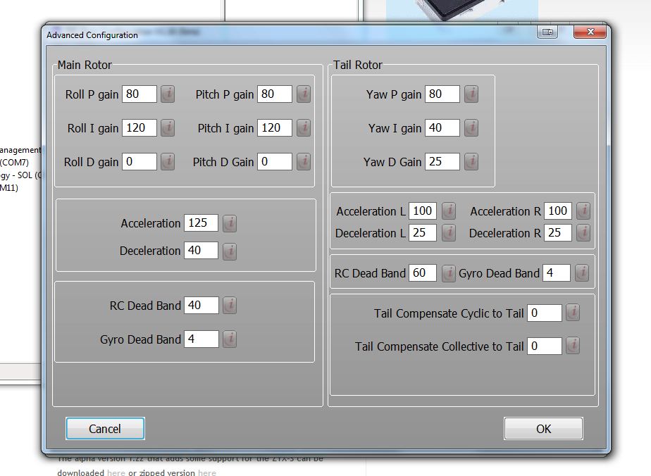

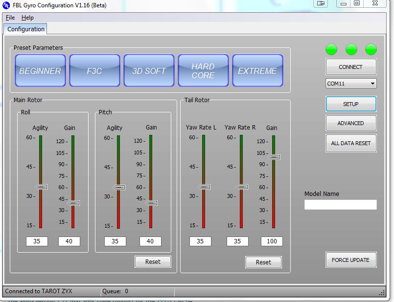

          Park Hall Helicopter Club
          • #65
            Originally posted by choppertastic View Post
            Ok. I've been out and about playing with the ZYX again. I am still struggling to get my head around this FBL stuff. I have my gyro gain set on 63% on the TX and cant go any higher otherwise it's tail wags like a dog on crack. I'm guessing its something to do with the gain at 100 in the screen dump but how does this relate to the gain setting on the tx?
            [ATTACH=CONFIG]46936[/ATTACH][ATTACH=CONFIG]46937[/ATTACH]
            Drop the gyro gain on the front page from 100 to 90. That should stop the wag. Then use the TX gain to fine tune at the field.
            You should also consider downloading the latest john-nz software which is version 2.1. When you have that installed follow the instructions you'll find on Helifreak (loads on there about the ZYX) and update the firmware in the ZYX to version 3.5. It is so much better and loses some of the glitches the original has.

            • #66
              If you have the ZYX set at 100% then the setting that you have in your Tx is the Gain. If it holds fine at 63% then leave it there - I have 4 of these on different helis and my Gain is lower than 63% on all I think - and they hold fine.

                • #68
                  Thanks Dave - I wish it were true.
                  The other option that you have if you want to raise your Tx gain is to drop the mechanical gain by moving the ball in on the servo arm, so long as you get enough movement to get full travel.
                  No I haven't got an "S" - I'm trying (unsuccessfully ) to keep my heli expenditure down.
                  What firmware are you running ? I recently upgraded mine to 3.5 and it is a real improvement - particularly if you are running with low cyclic gains due to cyclic oscilations. If you do it (recommended) then drop the PID D gains to 10 before your first usage.

                      • #71
                        Over the weekend I went through the setup again using Johns setup software (I also did V3.5 of the firmware). I also set my tail gain in the ZYX to 90%. All I can say is what a different it has made. It's now so responsive that I've had to dial in some expo. I have increased the tail gain in the TX to about 80% and no sign of tail wag.
                        Just need to get it to the field as I only had a play with it in the garden
