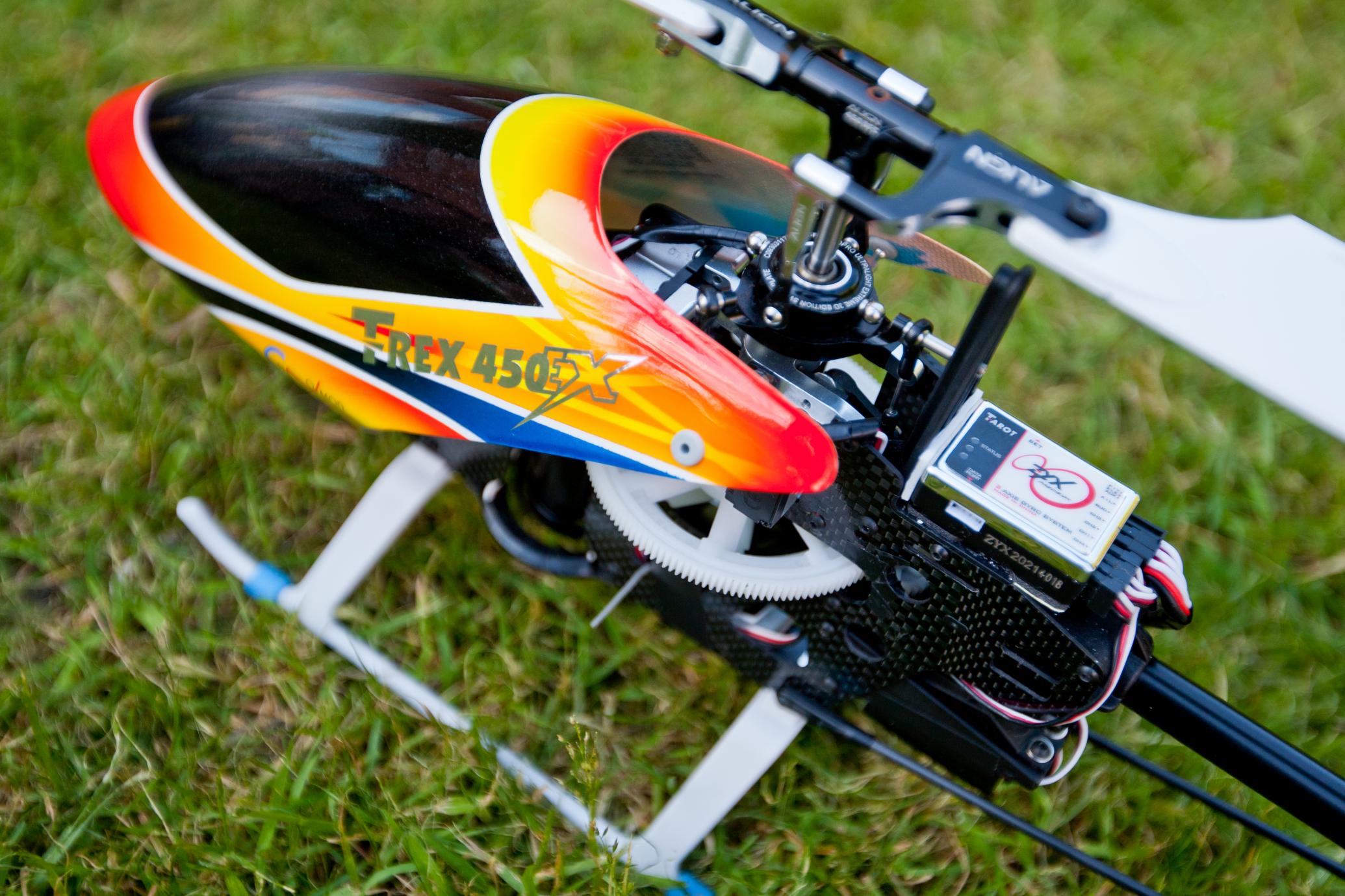

          Hi - I'm sorry I couldn't find the answer to this.
          I am about to make my 450 pro FBL and going to install my new Tarot ZYX onto my Align Trex 450 pro with DFC head.
          But I do not know what to select for the servo type for my heli.
          my servos are standard.
          Align DS410m and 520 for the tail I think.
          Can anyone please help?

            They are digital servos, and both are 1520 ms pulse rate. if you need to set the frequency as well then the DS410s are 65hz and the DS520 333hz.

            • #51

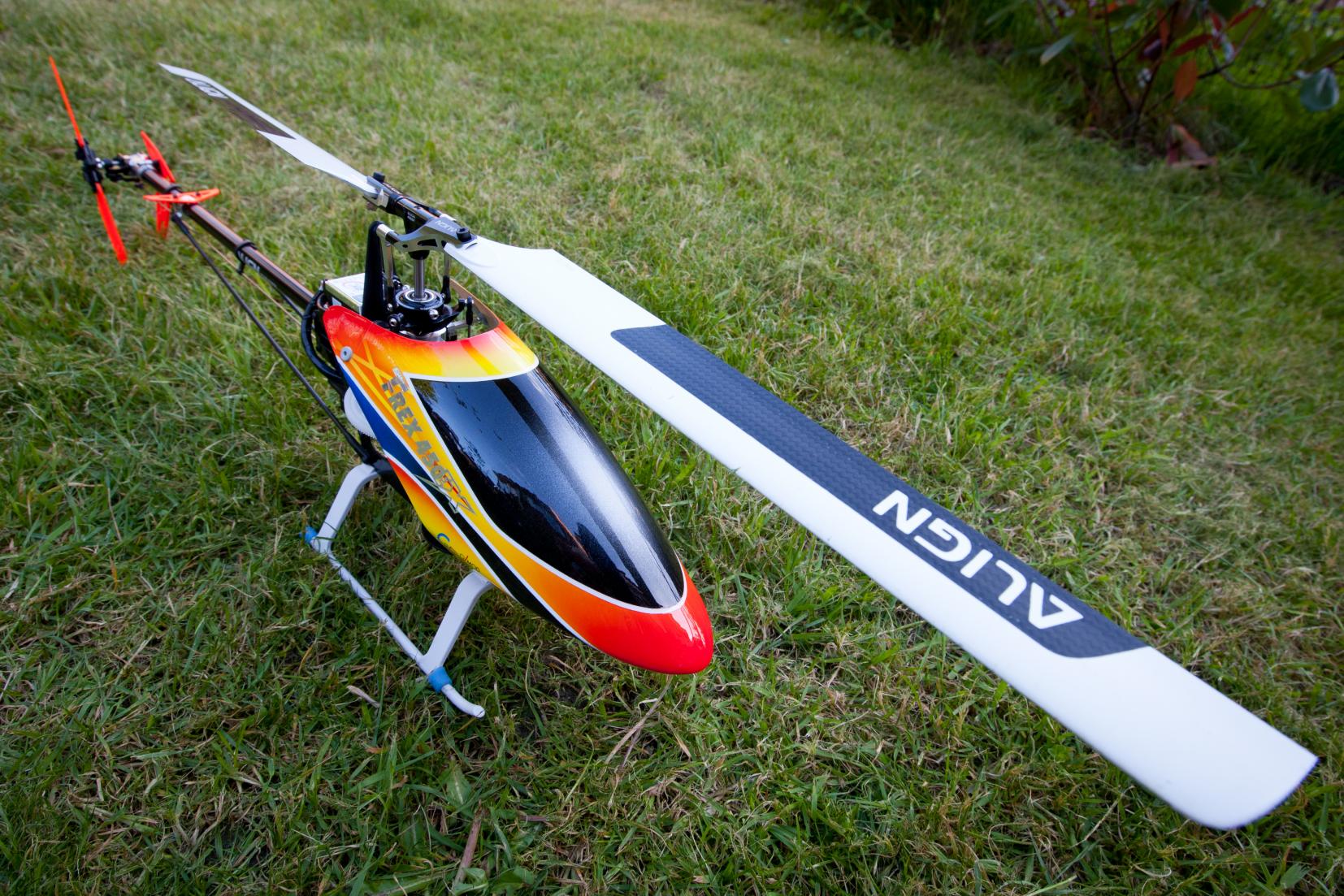

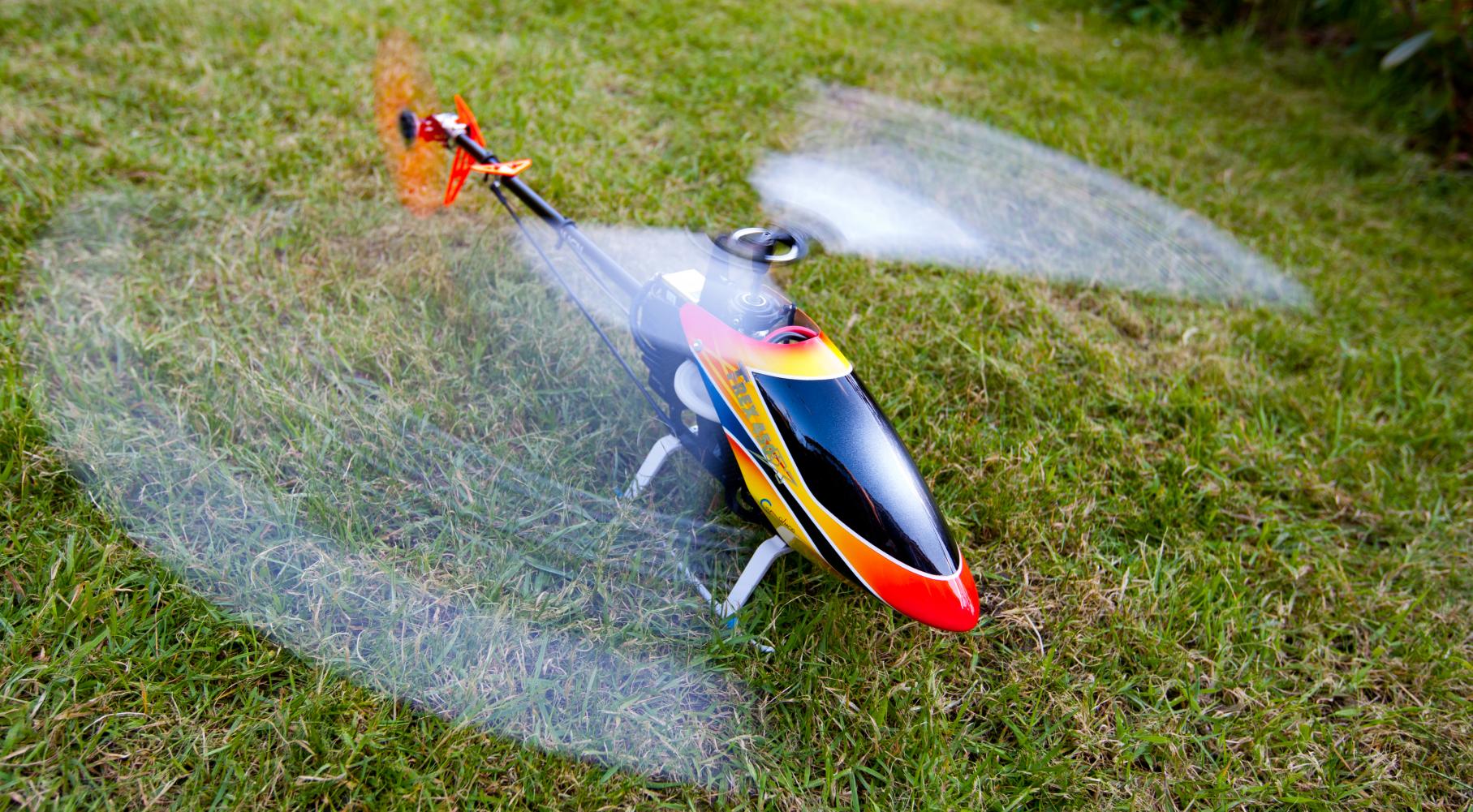

ID:	1869814here's my 450 pro with ZYX this afternoon in the garden. need to test it fully tomorrow hopefully if the weather is nice still
              • #52
                Looking nice mate, liking the nice neat install.
                Hopefully all goes well for you tomorrow.I think you will be pleasantly supprised by it's performance.Loving mine more every time I fly It.Just need to learn how not to crash so often lol.
