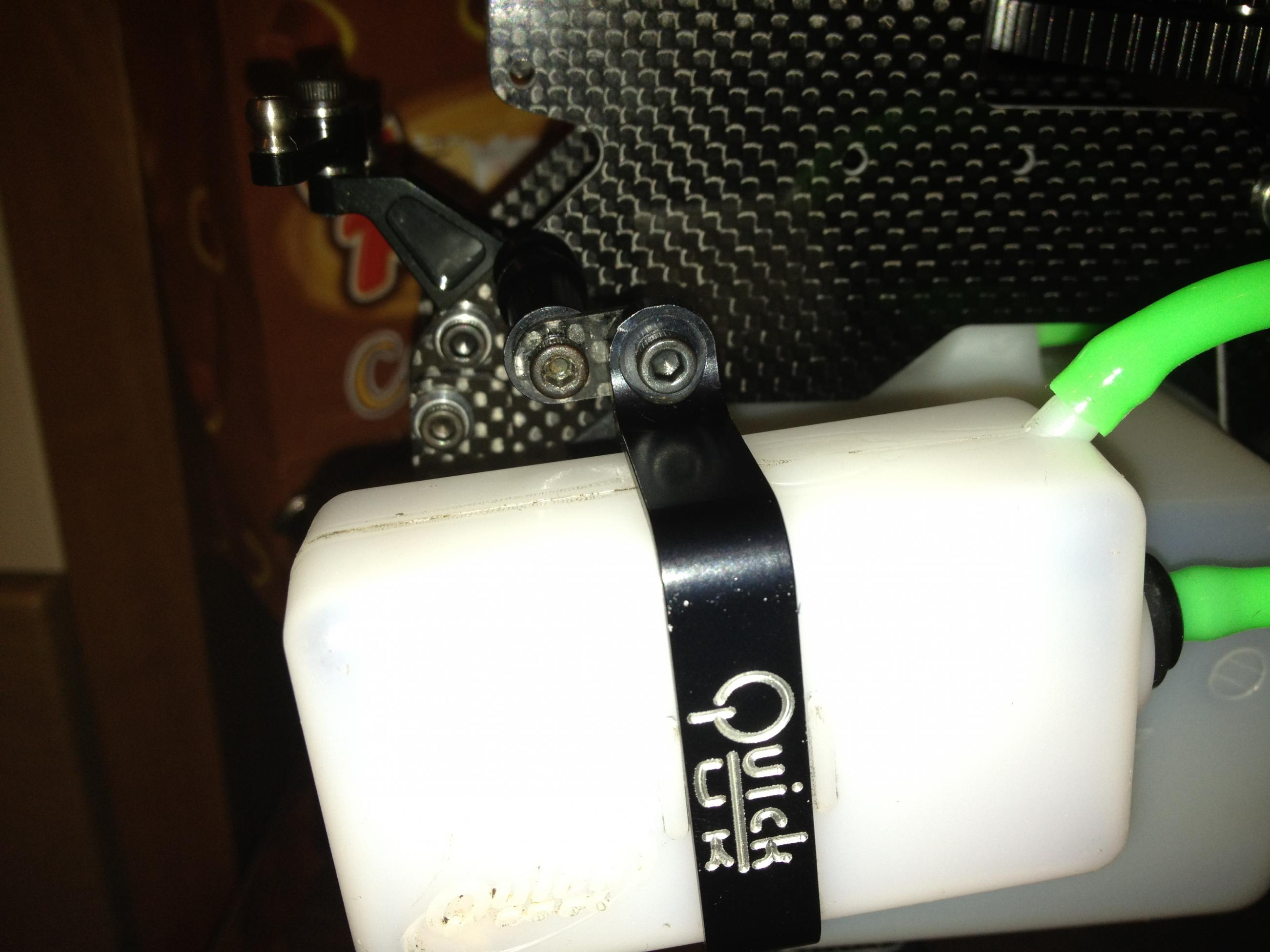

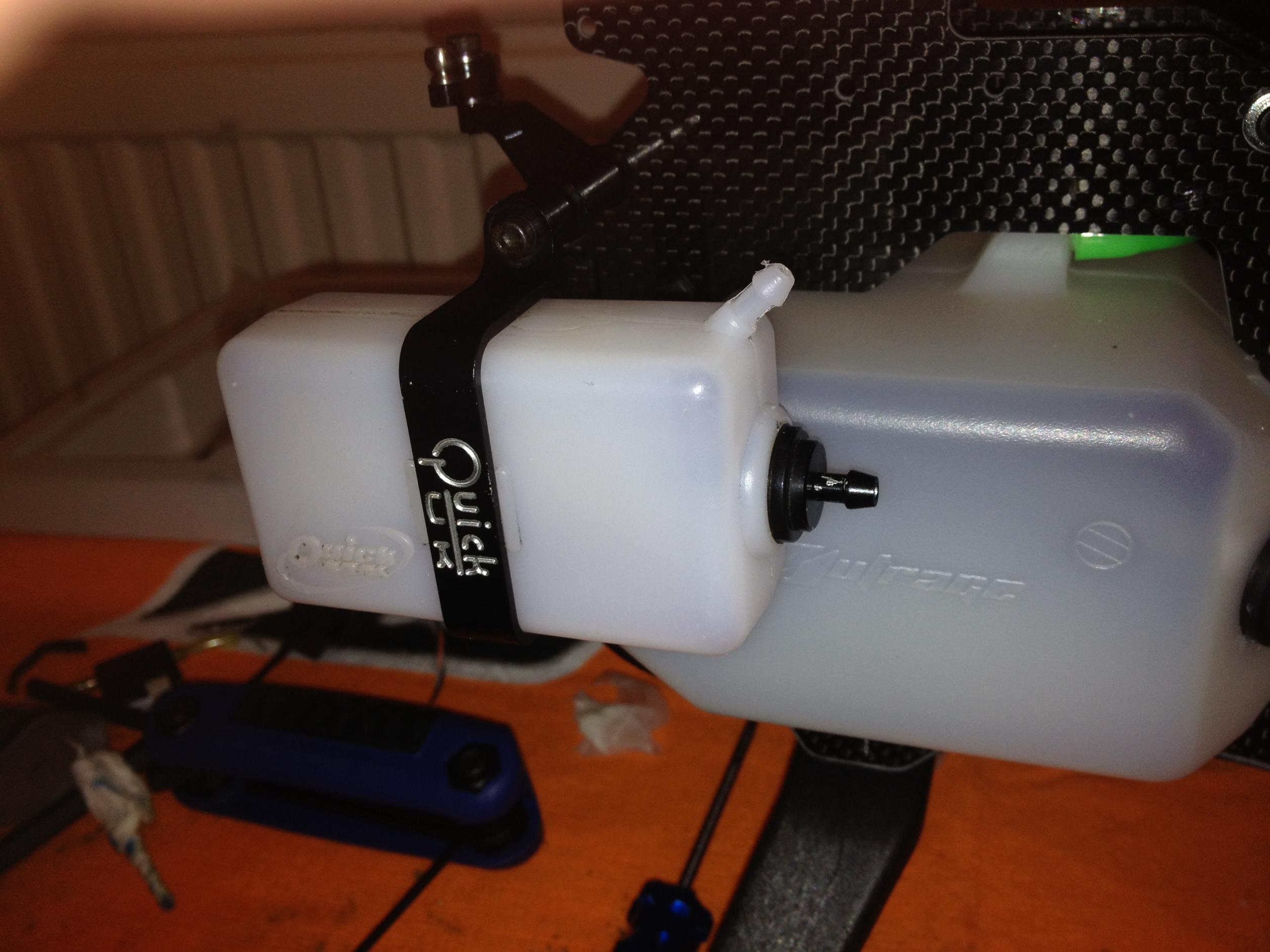

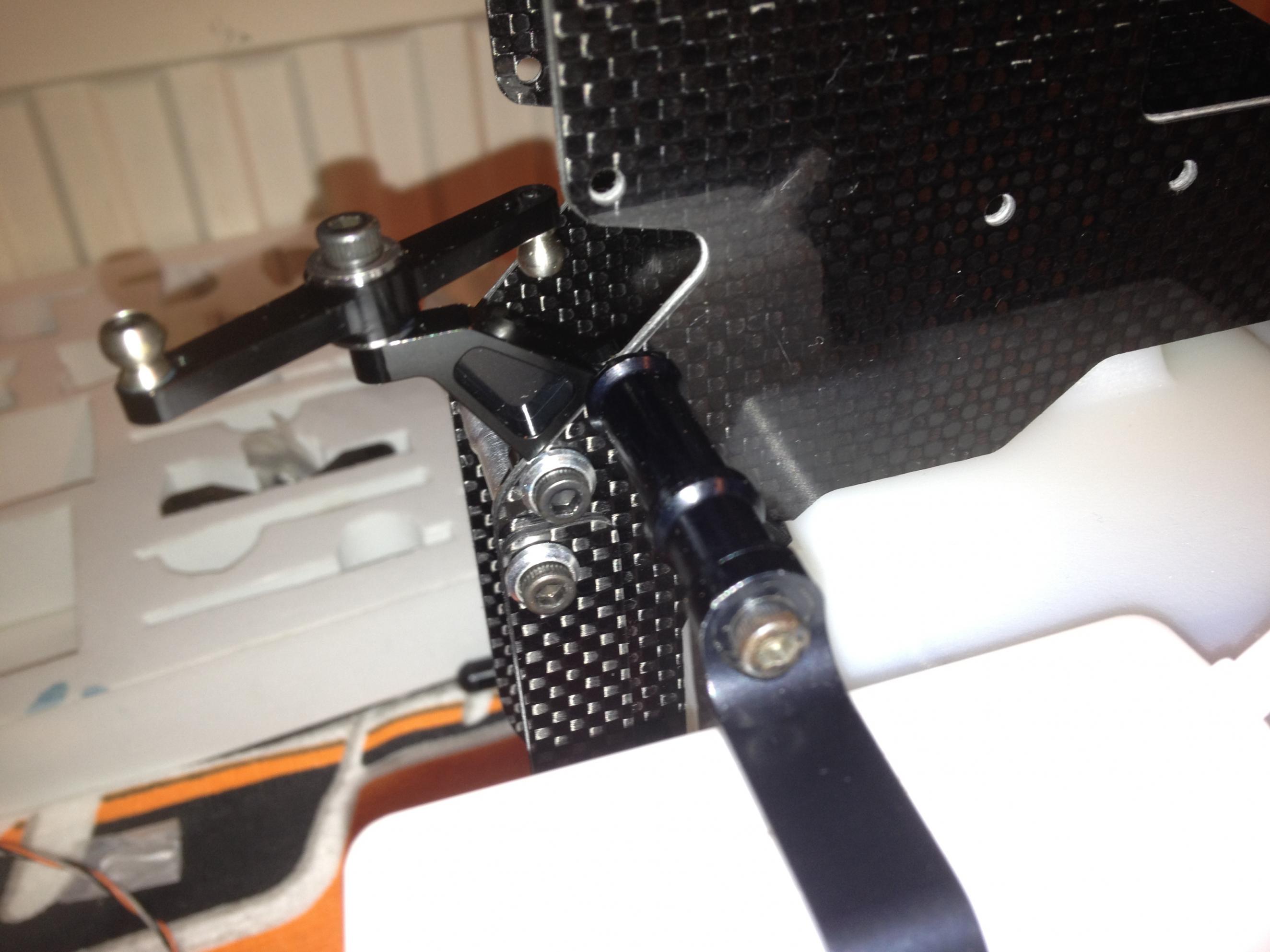

hi stuart and gate88 i have just fitted my quick uk one and it fits fine i have took a few pics for you
hope this helps

Not only will that upset the CoG fitting it back there it looks very prone for breaking the frame the first time it comes in.Originally posted by liamm =D View Posthi stuart and gate88 i have just fitted my quick uk one and it fits fine i have took a few pics for you

Your choice but I would be moving that further forward or removing it completely.
Yea I looked at that but it does seem like a long way back, I'm trying to make a bracket that will hold it level wit the front of the main tank.Originally posted by liamm =D View Posthi stuart and gate88 i have just fitted my quick uk one and it fits fine i have took a few pics for you

oh right sorry about that thenn its the only way i could think of
i am the lynx moas clunk but would like to us the header tank for aswell this may seem
and with regards to the frames breaking i do see you point but was thinking of getting a set of the the canopy break off clips and where the header bolts on to the spacer putting i was going to put one on there so it brings it forward a tiny bit not sure how that would work out tho
just had a go of doing it now did not bring it forwards loads but it may help save the frames so not sure if you guys would approve but its the only way i can think of with the standard parts
hope this will help

I did that on my trex600. Didn't even bother sealing around the tape and the header is still stuck firmly 2 years later. I have been really surprised at how well it has stuck (so have many others at our club)I thought the tank in the N2 was supposedly "larger than standard" negating the need for a header tank.Been a good build to read. Just waiting on my N2 kit to arrive so I can start on the build.Originally posted by waveydavey View PostTake it out of the bracket, put some double side sticky foam on the tank and stick it to the side of the main. Make sure it's clean and then use goop to seal around it. You can put it where you want then. If you crash and it comes off it doesn't crack your frames.
