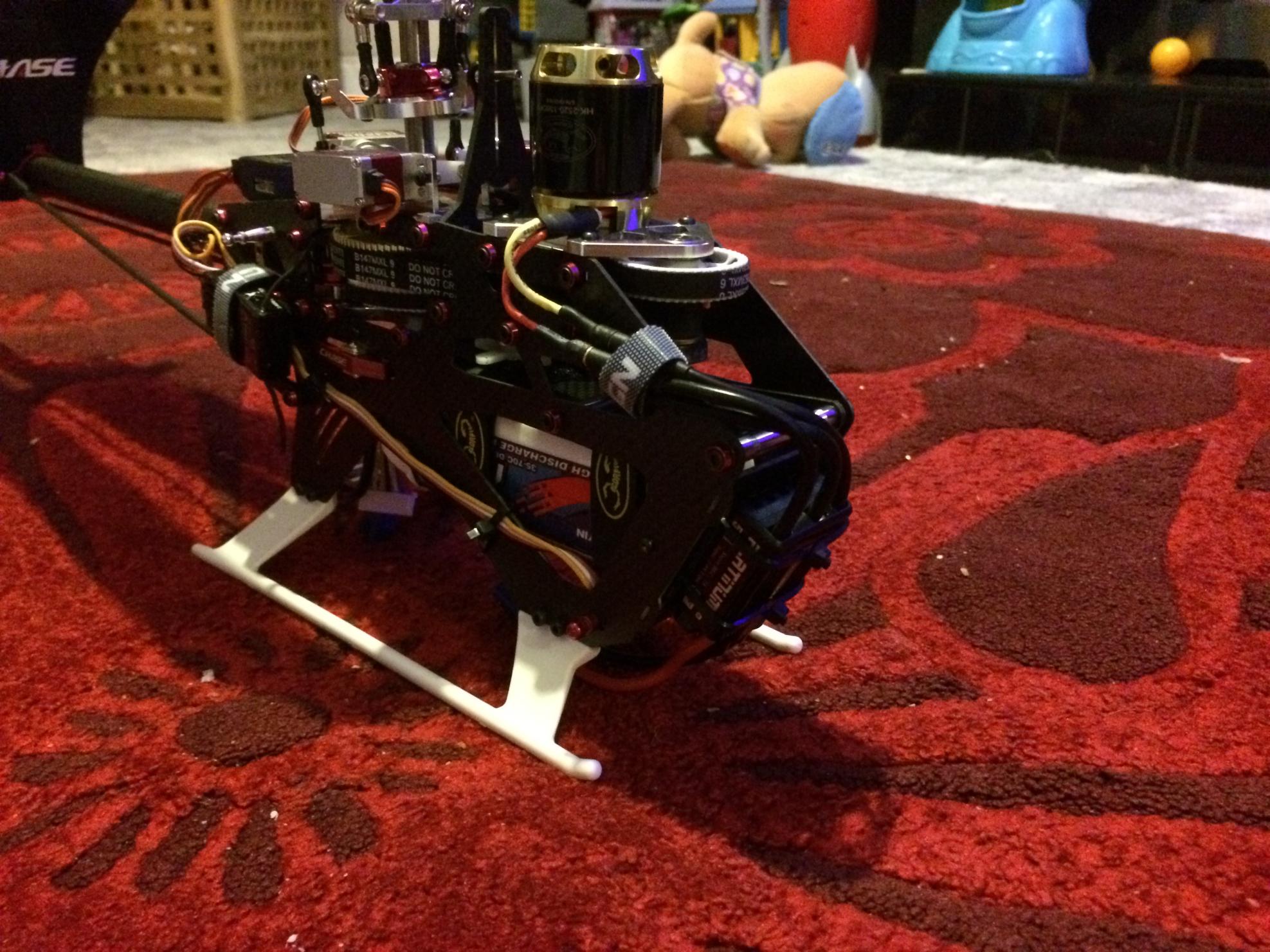

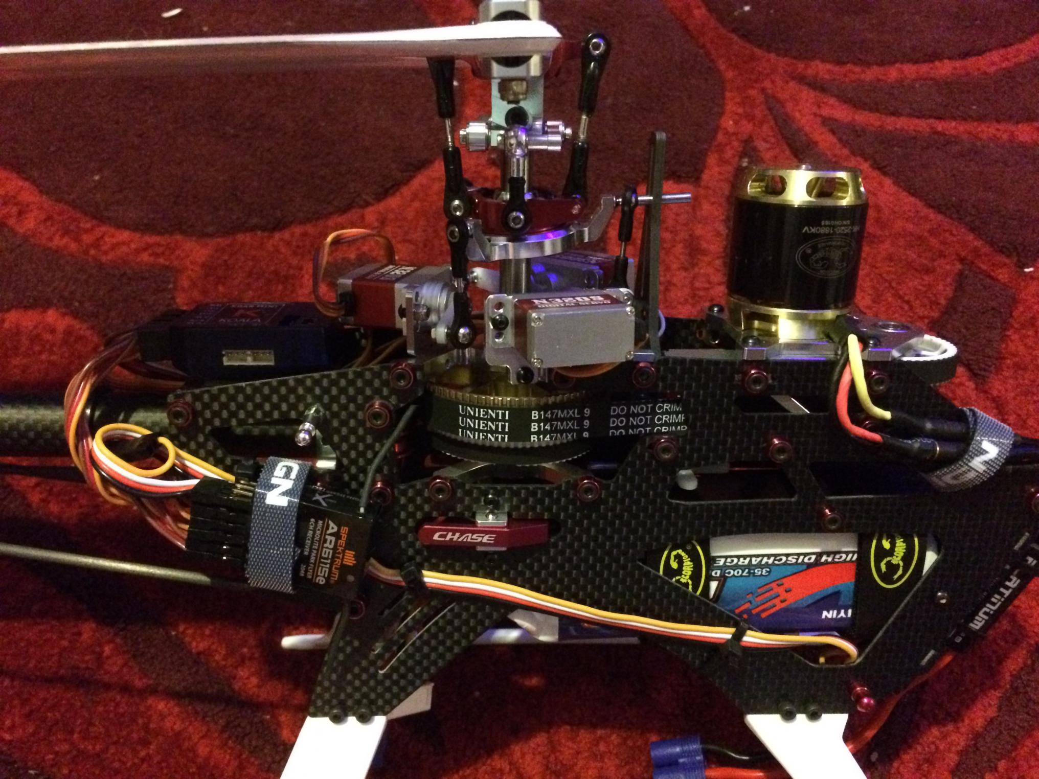

                            Sorry not great photos but took some to show where the electrics are, pretty standard locations really
ID:	1884379Click image for larger version
