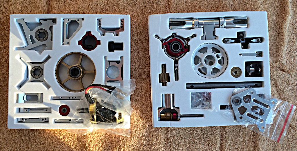

                          Box2 in there has the CNC parts and assemblies packed in a high density foam. A nice touch. All the metal parts look really nice quality wise. So far every pre-fitted screw has had loctite applied as well.

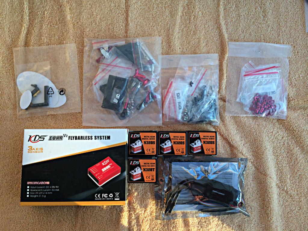

                          Box 3 has the electronics and the loose screws. These are all bagged with the sizes on stickers on each bag. There are a couple that don't have stickers on though.

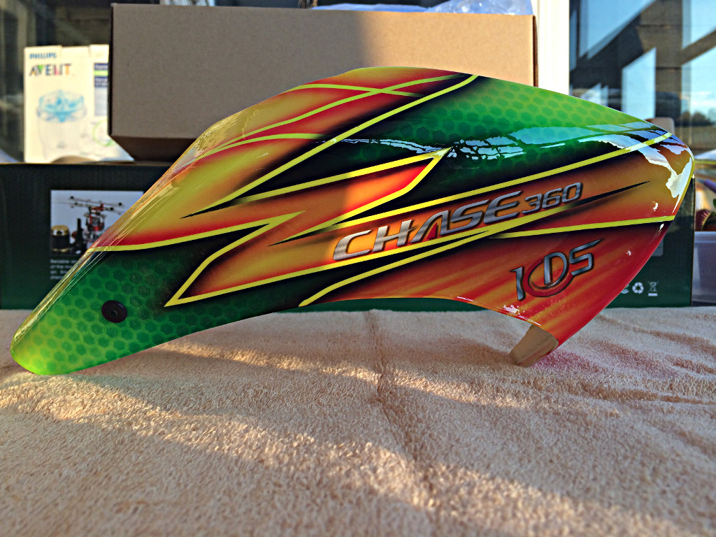

                          The canopy. A lot of controversy over changing this from the green, but I quite like the look of it now.

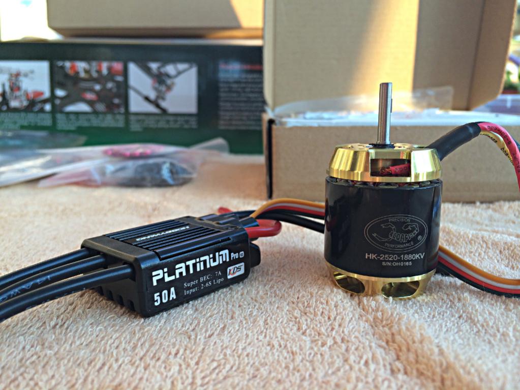

                          Motor and ESC. The Scorpion looks really nice.

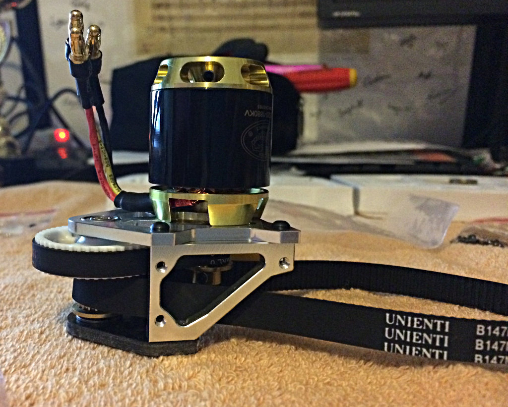

                          1st stage of the build is the drive belts/pulleys and pinions etc. Nice sturdy section once put together. This was where I hit my first issue. The motor screws don't quite sit flush to the motor mount, even thoguh they're countersunk, and so they protrude by a mm or so. This then means that the motor pinion has to sit a bit lower, which means the belt doesn't run perfectly center, it's running a little bit low. It doesn't come off the pulley in any way, but is lower than center by a mm or so. I'm considering trying to dremmel the head of the screws a little to get more clearance to get a more perfect alignment. The second issue is that the second stage pinion doesn't have a lip on both the top and bottom like the motor pinion. From things I've read on HF and HG it seems this is a mistake by KDS and it should have a lip on it to stop the second belt from sliding up into the gear above. It sounds like KDS have already re-made this part and it should be available soon.

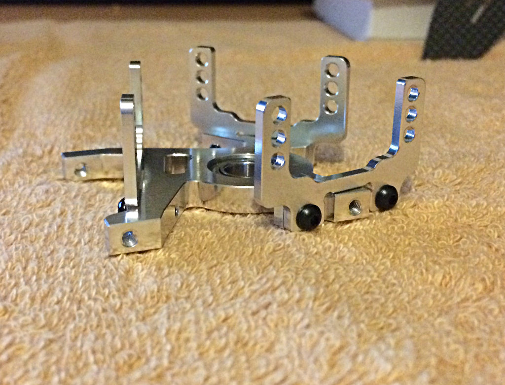

                          Top main shaft bearing and servo mount assembly. Sadly the holes in the servo mounts aren't tapped so bolts need to go on the back of the screws. Glen, the designer of the heli, has already highlighted this as something he would like to have been done, but it's probably no big deal, just takes a bit longer to install servos.

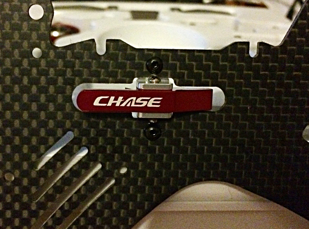

                          Love the detail of adding the screenprint on the battery release levers

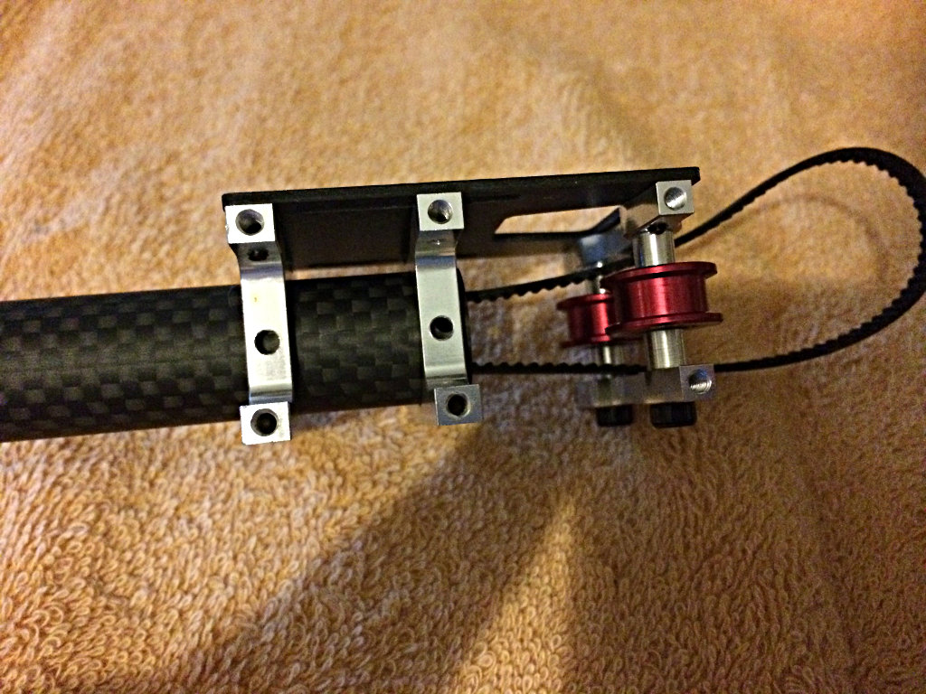

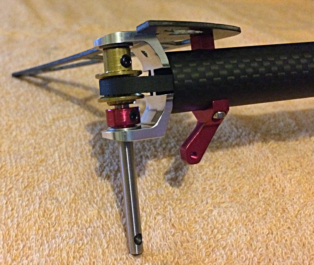

                          The boom mounting section of the tail. Easy to put together. The only thing the manual doesn't state here is which way to twist the belt. I'll have to wing it on this but I'm guessing it'll be the same as most belt helis.

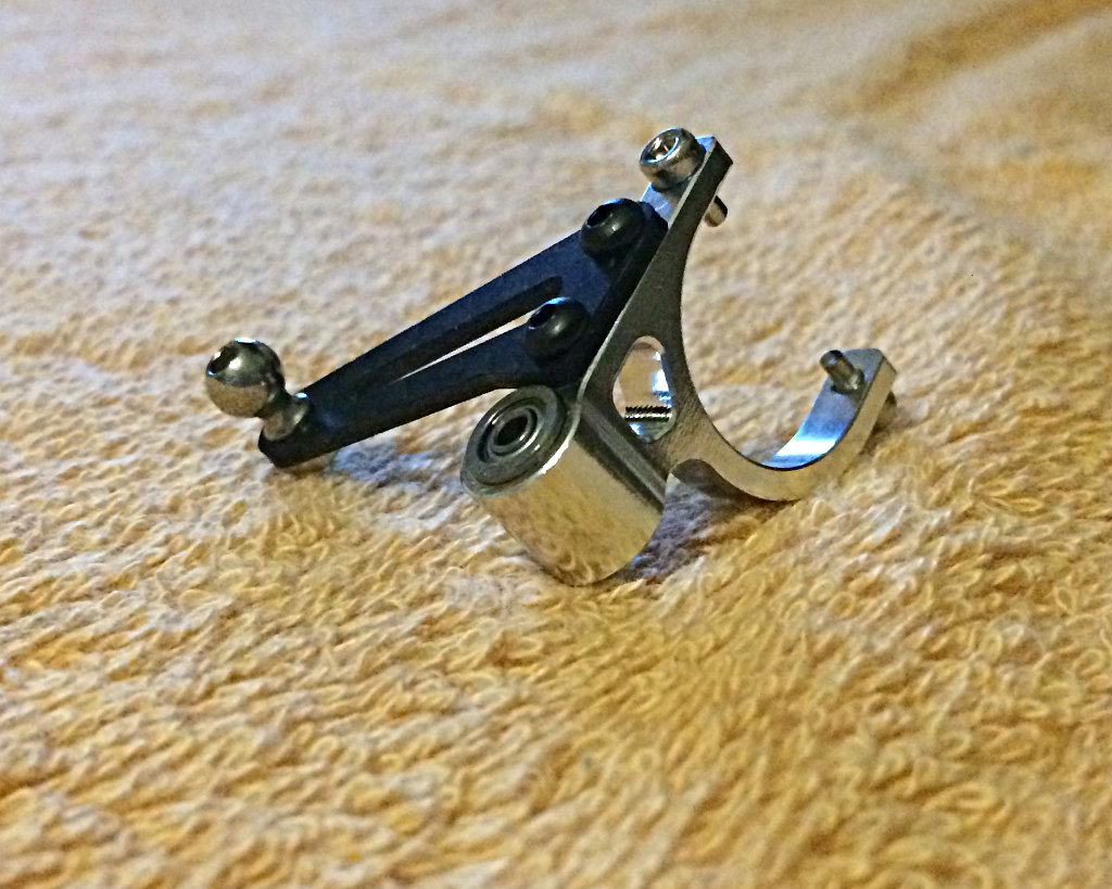

                          And starting the tail section. Here is another issue that's cropped up. There needs to be an M2x4 screw to hold the tail fin on at the back, only there isn't one in the packets labeled up. The other screws holding this together are all silver so I expected another silver screw, but nothing. So I think I have this missing from my kit
                          Tail control slider. nicely CNC'd as with all the other parts.
