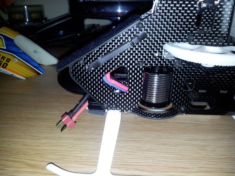

                    Hey
                    I'm back doing the heli. Anyone got any ideas on where to route the wiring for the ESC? I've put it under the battery tray with the batter connections at the top and just can't get the wires in without running them out side the frame.
                    Please help
                    Rich

                    • #70
                      Managed to fit esc & wires under the tray but had to cut a bit of plastic protruding from under the tray just needed squaring off so i could velcro the esc to the tray so theirs a gap between esc & tray to feed the battery strap through.

                      • #71
                        Thanks Jim I finally got it all under the try. Found a picture on google images. Only took an hour!

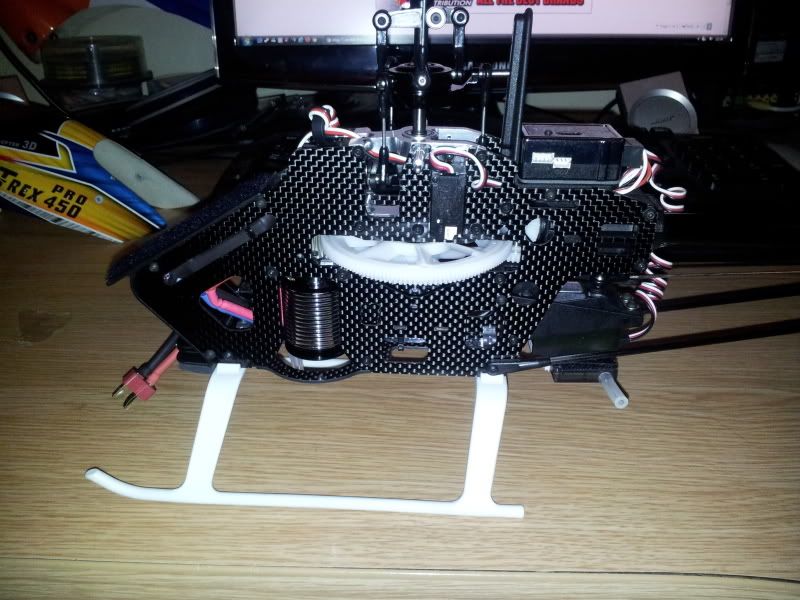

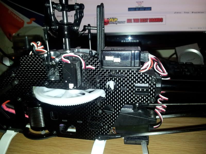

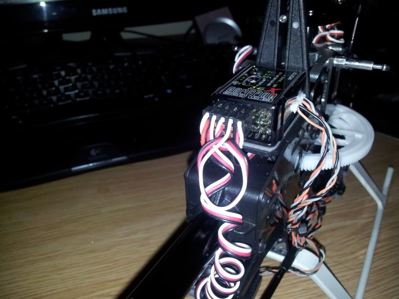

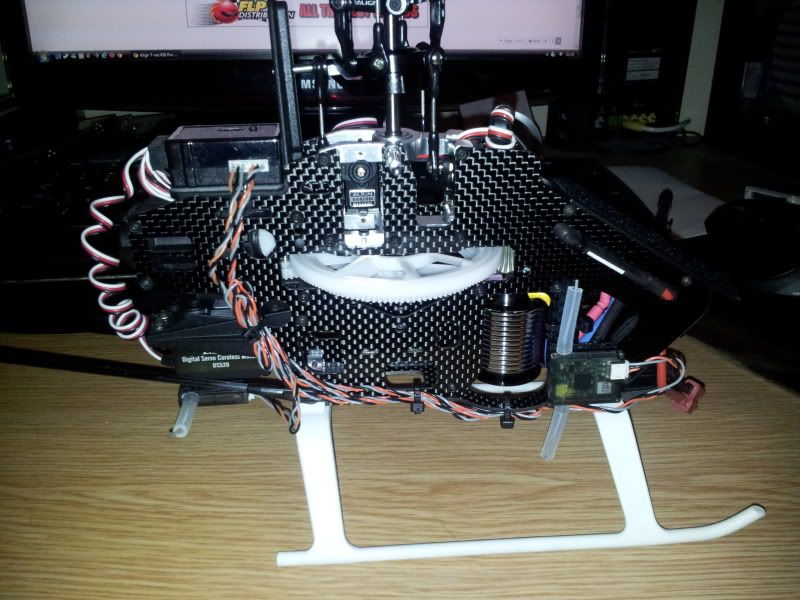

                        • #72
                          I'll take some pics in a bit, my phone needs to charge.
                          but, Mye ESC is under the battery shelf with the battery connection coming out of the cutout at the front. The motor wires are tye-wrapped to the side of the frame just in front of the motor. I've adjusted the ferrite ring so that it sits on top of the aileron and pitch servo then routed the Rx lead through the top bluck and got it secured between the elevator servo and the top block. The lead then passses under the 3GX unit and plugs in at the back.
                          The pitch and aileron servo wires I've routed similarly, but put a couple of dabs of superglue on and tuck them to the bottom of the bottom mainshaft block running just above the maingearthen up and under the 3GX again.

                              • #75
                                Ignore the satellite wiring, need a shorter lead as the standard one can reach to the moon!!
