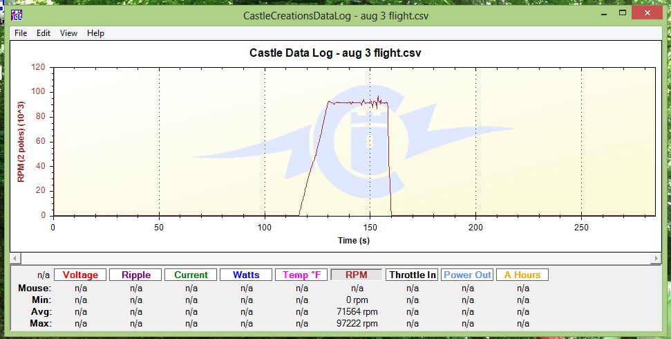

            Been watching the raw video of last night's flight and right after my pitch pump, there's a slight high pitch whirling sound (I'm guessing it's the motor) and right before I hit ground, about a foot off, is when I clicked Throttle hold and you can hear the motor spinning down...
            So do you think maybe Ice could be correct that the motor's still spinning and it's really my OWB slipping?
            If you look at this log of my RPM - does this show my motor overspeeding? I don't really know how to read it.
                [ATTACH=CONFIG]65424[/ATTACH]
                That noise can sometimes be the governor gain being to high.. we call it chirping, it could also be a mechanical thing like the owb too!
                In the castle logs screen you need to tell it how many poles the motor has in the settings for it to give a proper rpm readout. atm its saying you have 100 rpm headspeed lol
                Matt

                    97222rpm pretty impressive haha
                    • #55
                      Haha. I thought the log would be based on the settings i have given it on the main pages.. I did notice that 2 pole line on that log. How do I change it?

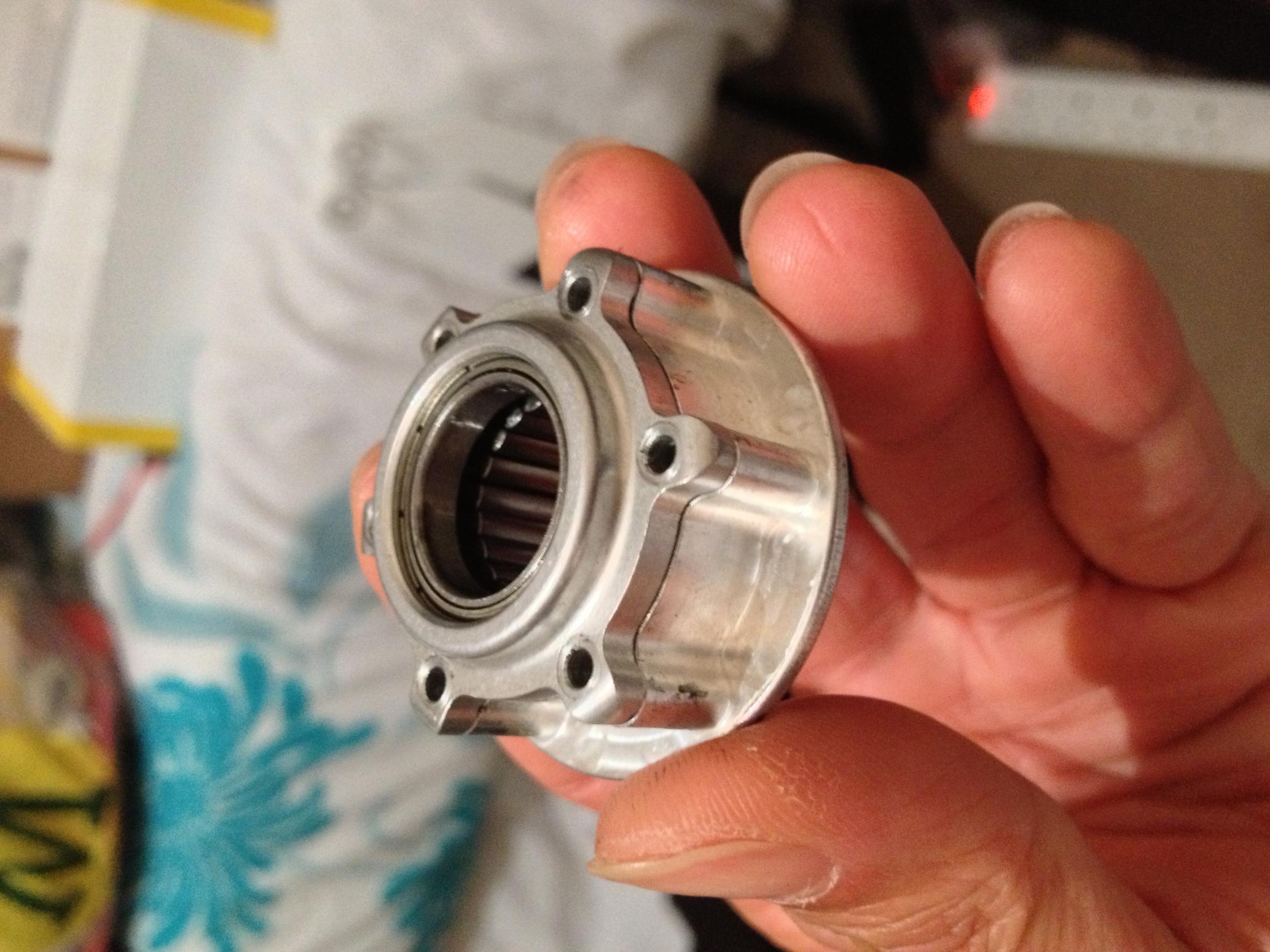

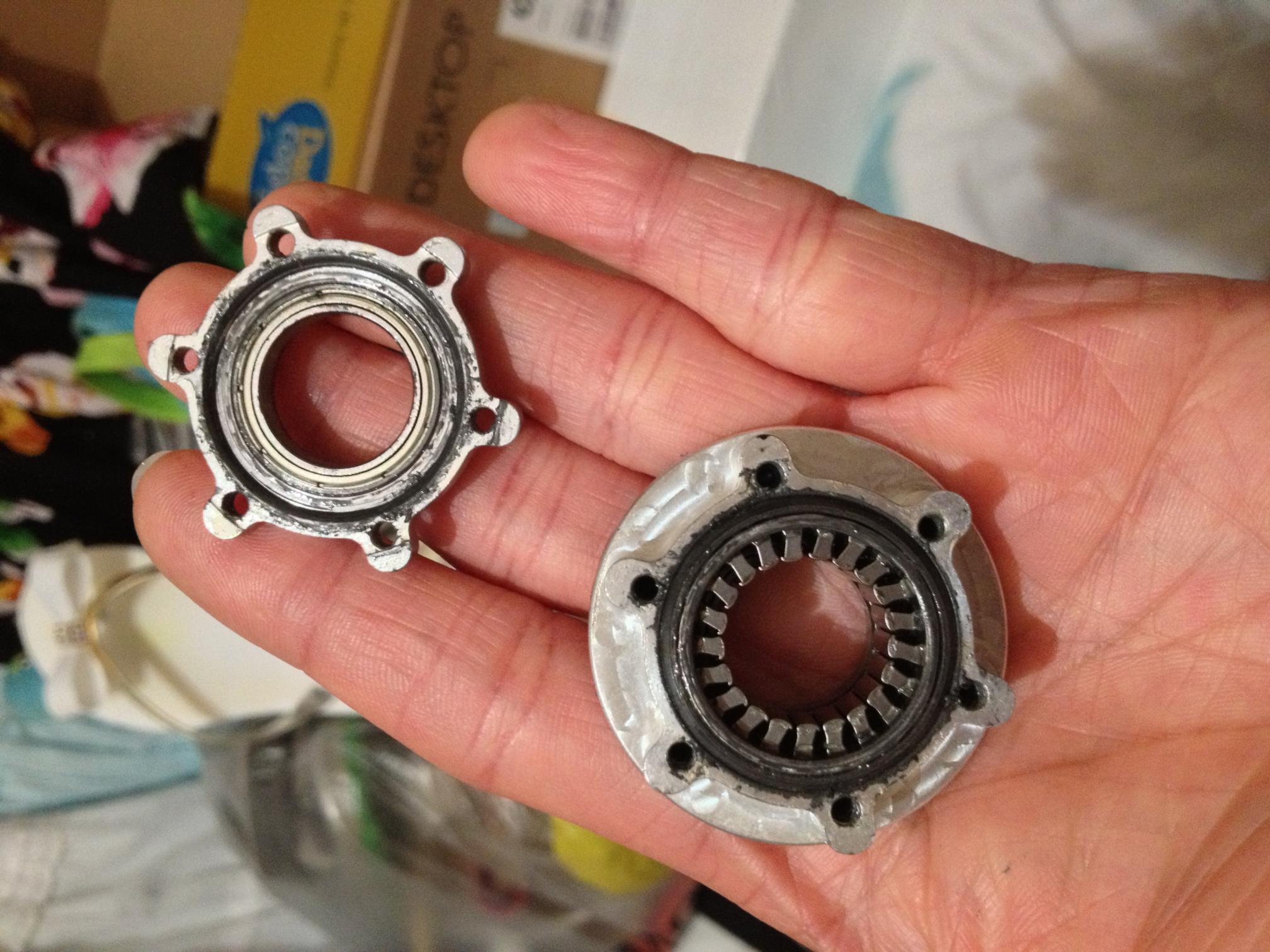

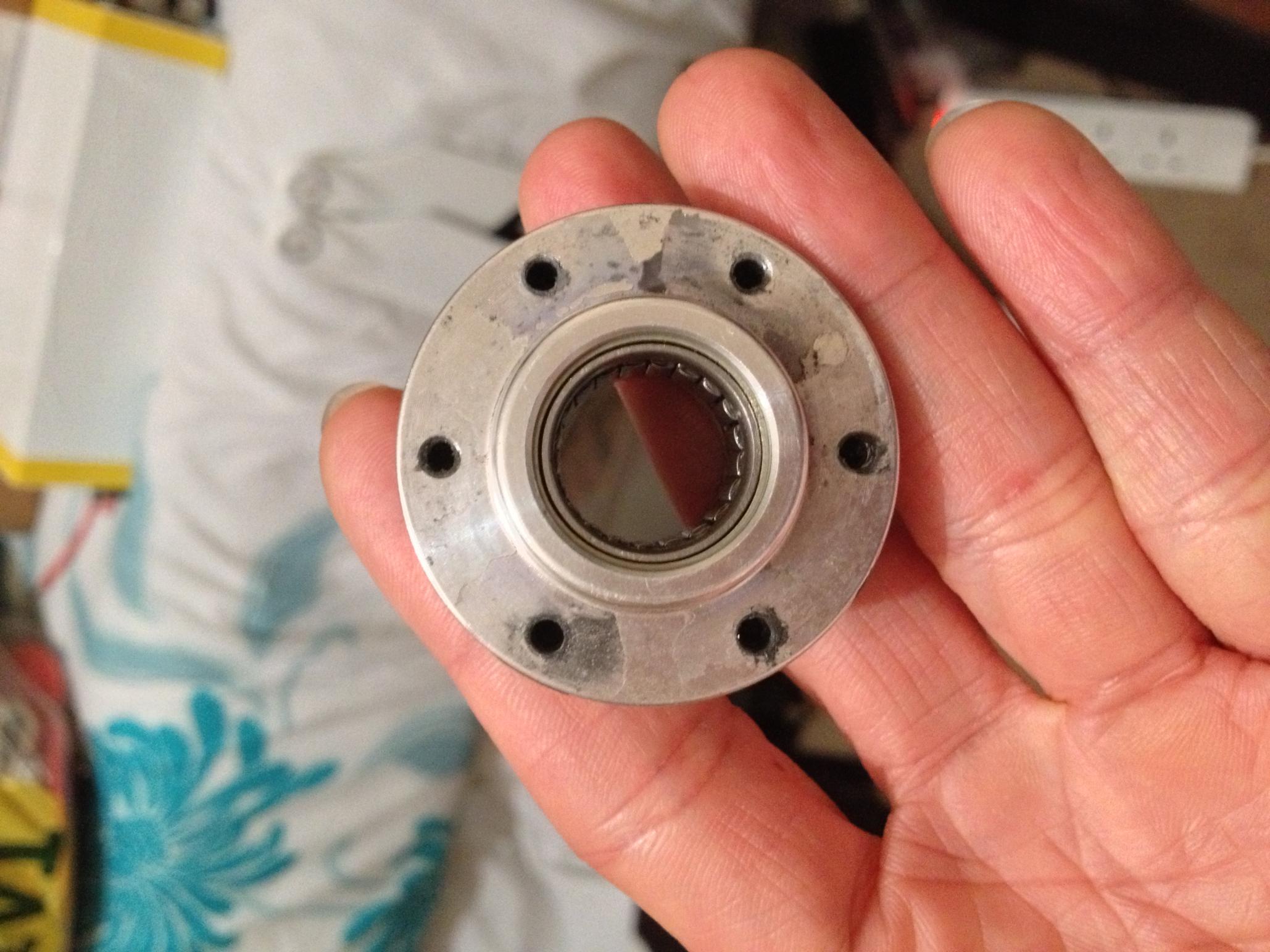

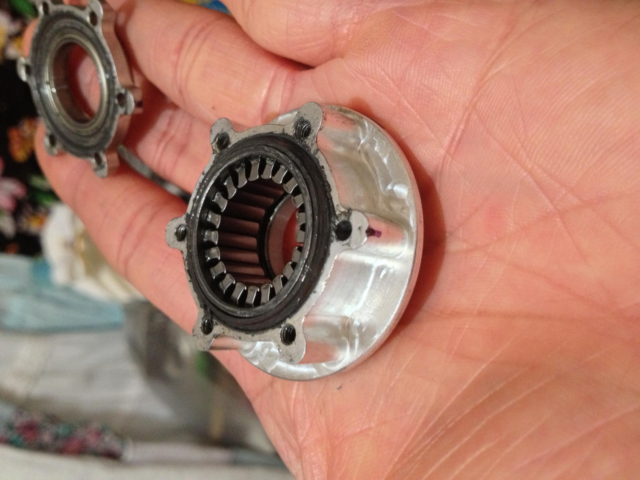

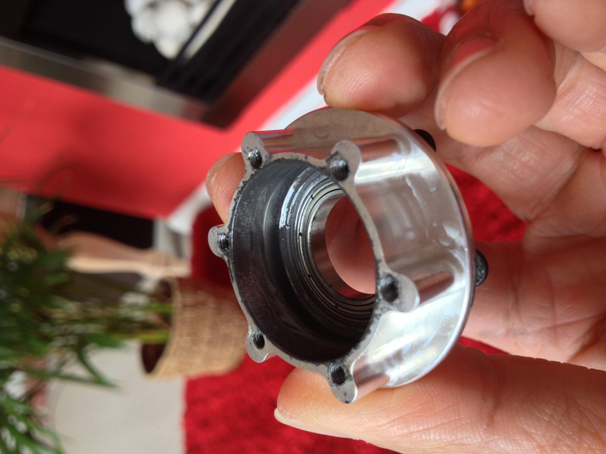

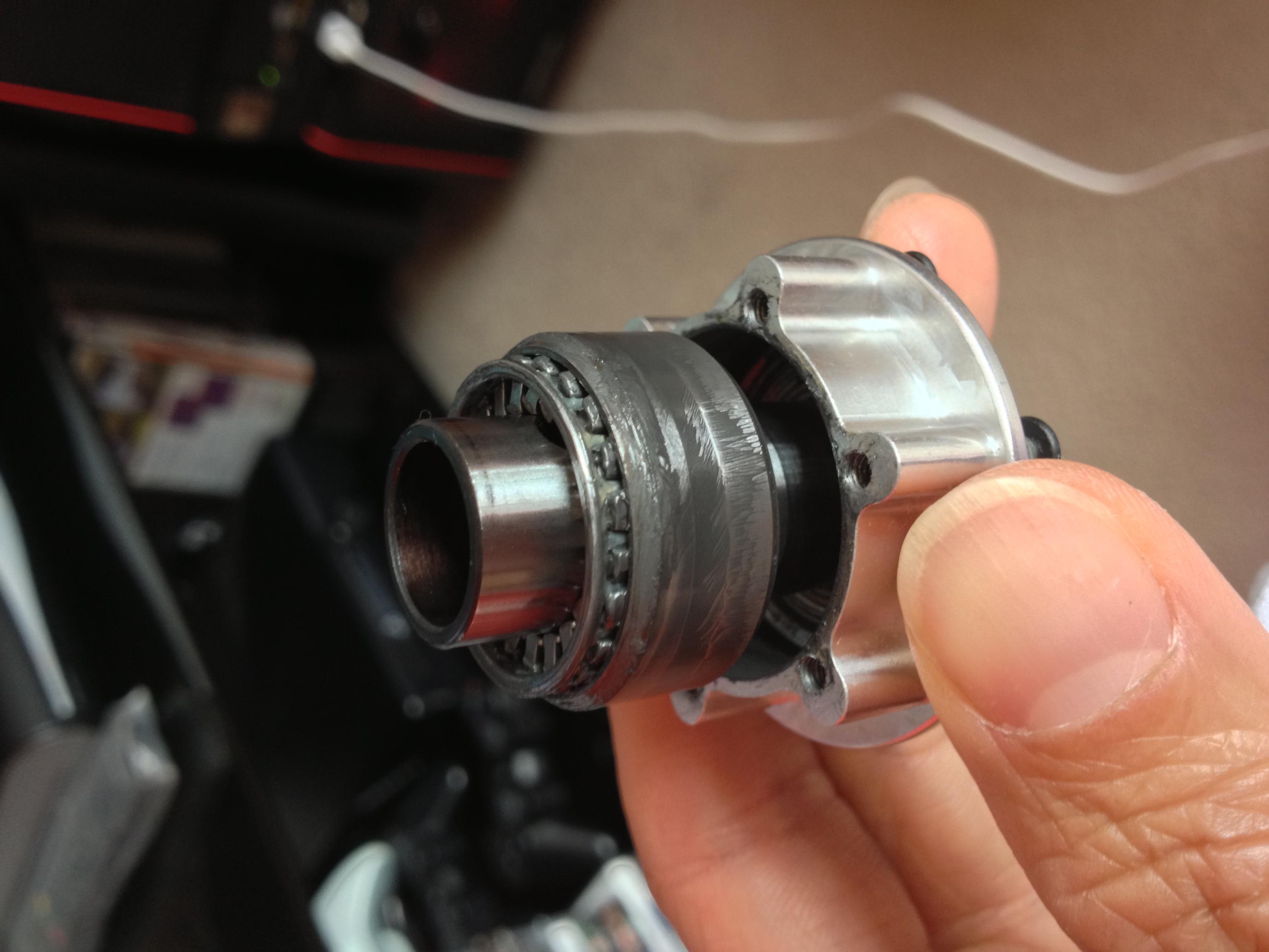

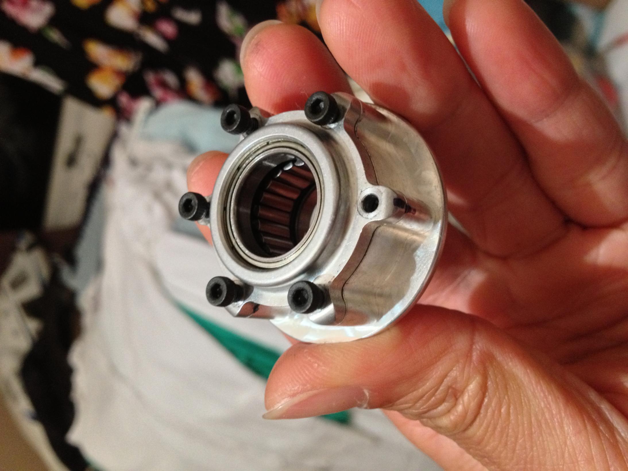

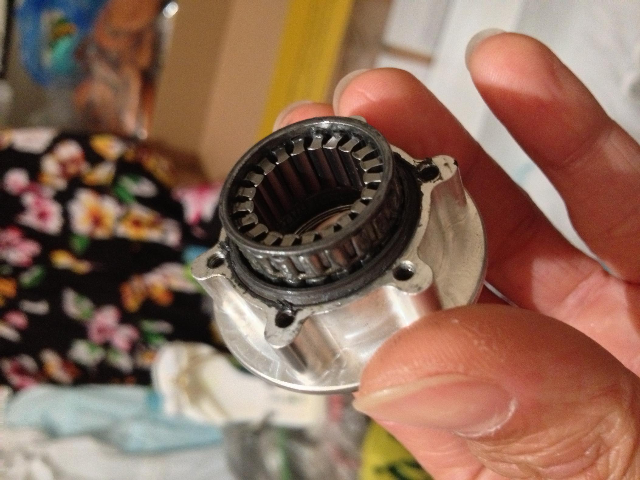

                              Ok - Finally managed to get some time to pull the One Way bearing out last night and have a look. What do you guys think?
                              Oh, one of the screws' thread is messed up - the screw was just spinning with no bite (don't know what the proper term for it?) - Will this be a major concern?
                              And with all the screws loose, I managed to spin the One Way Bearing the other way...
ID:	1879835Click image for larger version
ID:	1879836Click image for larger version
ID:	1879837Click image for larger version
ID:	1879838Click image for larger version
                              And this is the one with the messed up thread

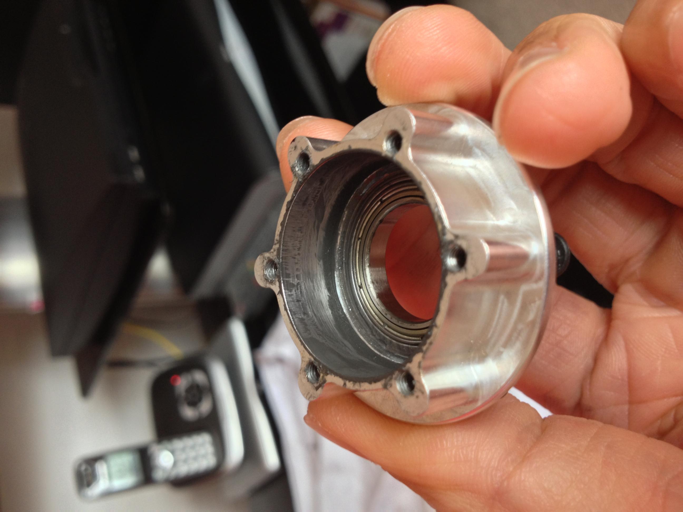

                              • #60
                                Hmm - I take it this inner sleeve should not have grease or oil in it??
ID:	1879841Click image for larger version
