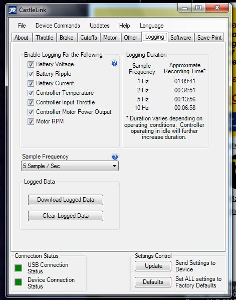

    So I checked my logs but I only had 2 things switched on my logging and they didn't look abnormal so I switched everything on and I also calibrated my Low and High throttle points on the ESC.

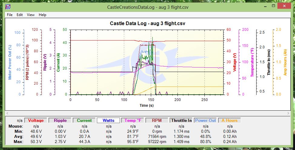

    Some people on here have suggested it could be the One Way Bearing which I will check as well. For the time being, here is full log from the flight. Tell me which tab you need to see in closeup and I'll post. Thanks again for the help!

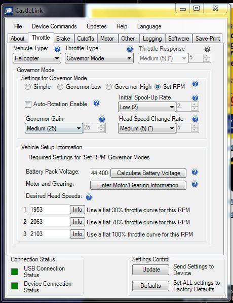

                Not using Vbar gov. I'm using Castle's gov mode (30% 70% and 100% throttle flat line settings)

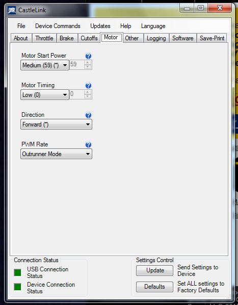

                Here's the screenshot. File is dated Aug 31, 2013 so this has got to be the updated file I have before my flight last night.

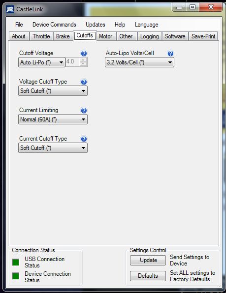

                Hmm - I've noticed on this file that my Current Limiting is not set to Insensitive. I used to have it set to that before... would this be the reason?

                    in the cutoff's tab, where it says "current limiting" 60amps is way too low mate, soon as you pitch pump you'll get a current spike which will cut the esc off. you need to change this to "insensitive".
                    Give that a try first.
                    If it still doesn't work then in the governor tab, change it to "governor low" or "governor high" - a guy at our club was having weird problems using the "set rpm" setting (possible software bug) but this was on a 160a HV esc so may be different.
                    Certainly change that current limiter though!

                      Current limiting is set to 60a and this heli is a 120hv on 12s. Set it to disabled or insensetive and it will fly fine. Same thing happen to a flying buddy with a 700e, he set it to 80 I think and it cuts off mid air. Good thing that we have practiced auto and he landed it safely. Another thing is your motor timing set it to 5.

                        Thanks. i shall check that off the heli tonight as soon as I get home. I've always had it set to Insensitive so don't know why it changed and how I missed it off. Maybe when I updated the firmware, it changed it or something..

                        Current limiting is set to 60a and this heli is a 120hv on 12s. No wonder it is cutting off. Set it to disabled and it will fly fine. Same thing happen to a flying buddy with a 700e, he set it to 80 I think and it cuts off mid air. Good thing that we have practiced auto and he landed it safely.
                          Whenever the firmware updates itself then all the settings go to defaults.. so you need go through the whole lot and check everything..
                          As said the motor settings could also be better but I figured leave that until you get it flying right 1st. solve one problem at a time kinda thing.
