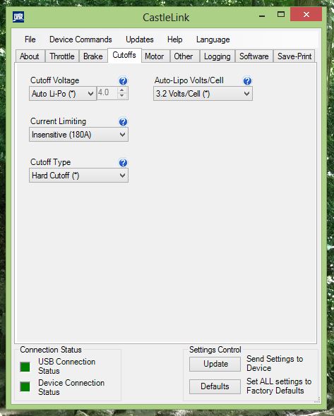

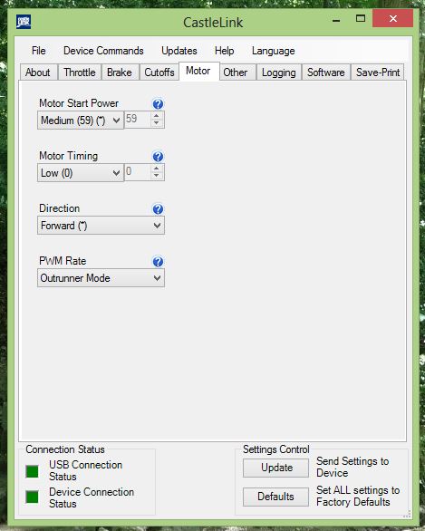

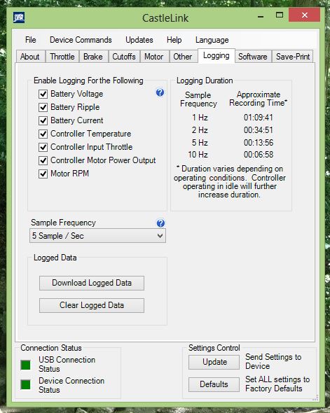

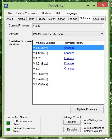

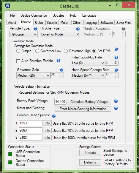

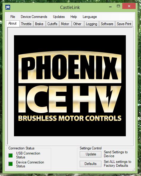

                              Can you post the correct/updated screenshots of your esc settings..
                              Matt
                              Goblin 500 Sport
                              Owner of
                              One E.G.S.
                              • #45
                                My saved file (when run in demo mode) shows NORMAL CURRENT LIMITING but when plugged into my ESC, it shows as INSENSITIVE. Strange...
                                Anyhow, here's my settings direct from the ESC connected to my pc.
