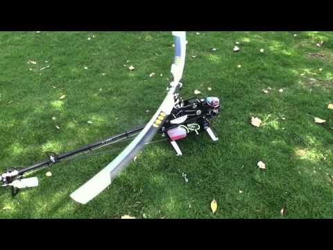

                    check this video I found on YT, I think I did hear this kind of sound just before your motor went to limp mode...

                        check this video I found on YT, I think I did hear this kind of sound just before your motor went to lump mode...
                        That looks more like owb is wrong way up??

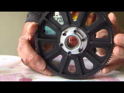

                              Ok, I took the main gear out just now.. here's the video. What should I be looking for?
                              • #30
                                Unscrew the top and take out the bearing, on mine it had metal swarf around the inner and outer of the paws.
