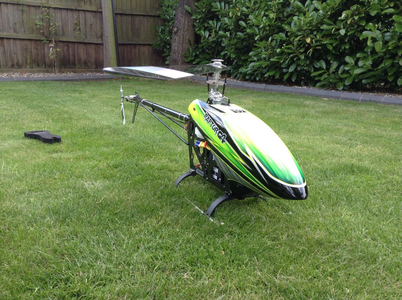

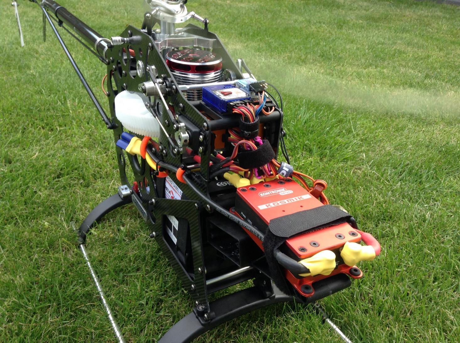

                        Here are a few pictures of my E750. The same as my E820 underneath.
                        The E820 with Align 780's has a lot of pop and the Slightly shrunk down E750 is very precise and both very enjoyable. It really does show how different blades have such an influence on style.
                        I don't use a external BEC so minimal components to mount plenty of space as esc can go at the front on top/underneath, side mounted or rear.

                            Thanks for the pics Maj,
                            Given me some ideas. Neat work with all that shrink tubing. Those Kosmiks really do look the business, especially with the bolted connections.
                            You run a seperate receiver with the Vbar or Vbar not use sats? And what's the gubbins on top of the reciever?
                            I guess flybarless units don't mind other gear and the motor being that close to it?
                            Can you use long 6s packs with the e820 or do you need a different tray underneath?

                              Gubbins are receiver and a jlog mounted on top. 6s long packs unusual but try and if not put the optional carbon tray on. If you haven't bought the packs buy more standard ones!
                              MJ
