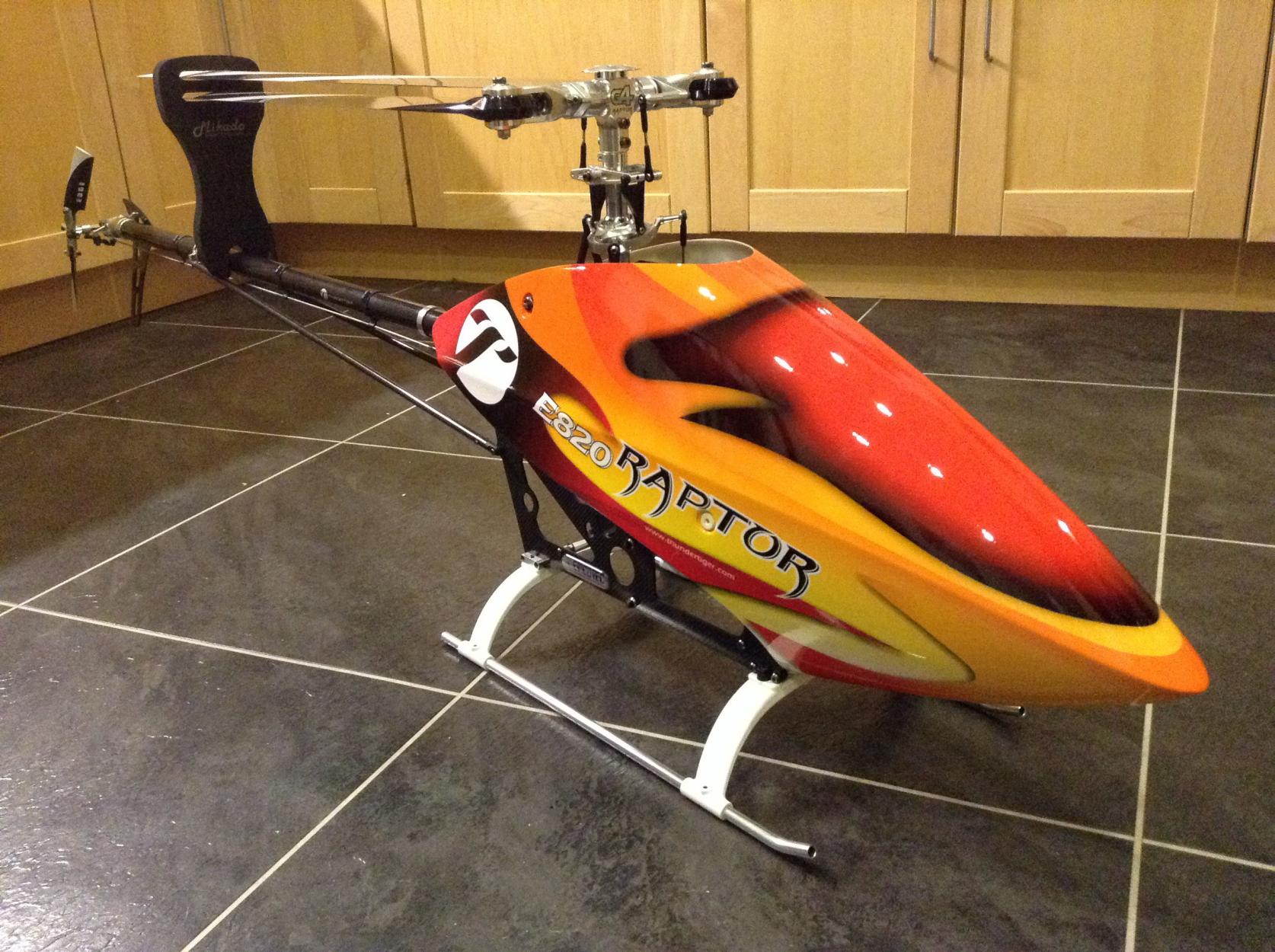

      Just upgraded one of my E720's to an E820 and it works a treat.
      Don't anyone get confused the 820 is just a stretched 720 with a longer boom, torque tube, canopy, blades and obviously the gearing has to be adjusted for efficiency.
      I was eager to know just how 12s would cope with the massive 815 Edge blades but after a little pinion changing and a lower kv motor this thing rocks.
      Having had both the Logo Xxtreme and the Goblin 770 both on 14s this Raptor eats them both for lunch on 12s regarding agility and power output due to it being almost half the weight.
      The question remains is it up to the job, I had a main gear break into 3 pieces today but blame myself for getting the meshing too tight, easily fixed and ready for flying again as I type this.
      Double bonus is it shares the same battery trays (and batteries) as my current e720 G4's so its a win win situation.
      As soon as the weather picks up I will get a video posted, Ben Mayhew (heliben on here) watched me fly it both yesterday and today and its certainly no slouch.

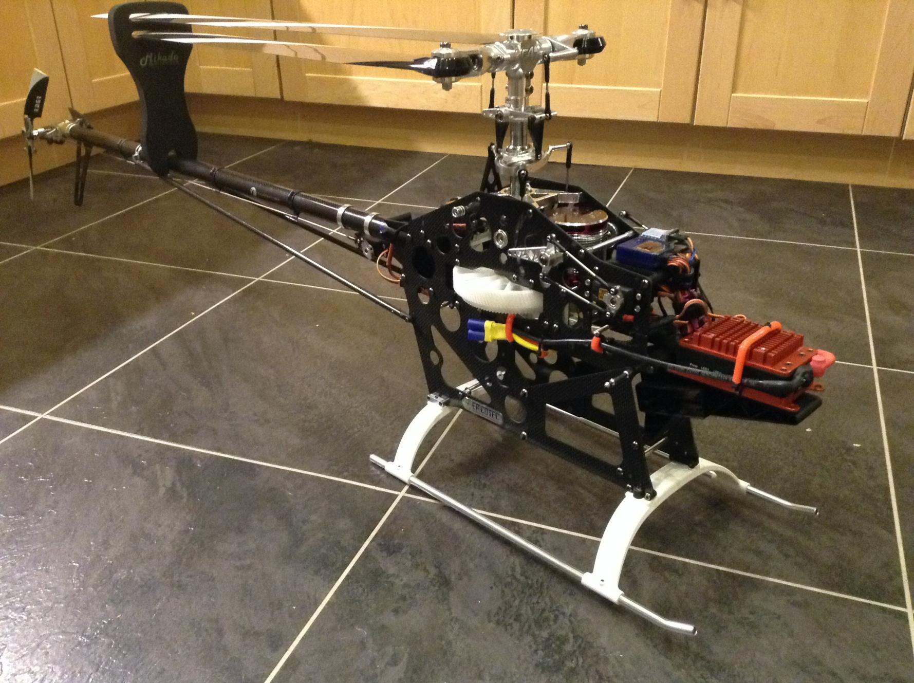

                Cheers Tim, got any pics close up pics without the cano. Also, when you had the Kosmik, was there any other place for it other than on the side? I dont mind putting it there just wonder how much it would upset the heli if at all??
                Still much to think about. So many options with the larger heli's atm. I could also go and make the Triabolo an 800 or get a Diabolo 800.
                  I'm sure Mattie Lodge squeezed a Kosmik under the boom mount, Maybe he still has the image somewhere.
                  This is the nearest picture I have.

                      ImageUploadedByTapatalk1385936156.100540.jpgImageUploadedByTapatalk1385936171.548588.jpgImageUploadedByTapatalk1385936186.564912.jpg
                      Boom block mounted kosmik
                      It's a bit tight but does fit under there

                          Nothing stopping you using it, I try to get the C of G correct and spreading the hardware out this way proves easy.
                          Double bonus of connecting the lipos from the rear is you never have to remove the canopy all day.... Winner.
                          • #28
                            Yes CoG is important so thats the reason its not used.
                            Under the boom block it would be then for me I guess. Only issue being getting the SD card out but after the first few flights I guess it wont need to come out unless theres an issue.
                            • #29
                              Front mounted Kosmik keeping the no canopy off approach for loading the batteries, best of both worlds. This machine is the best 800 class I have owned to date which isn't many ;-) It has so much agility at low headspeed where others required the headspeed cranked up to get them moving prob the fact the other main one weighs a ton. Will see how it holds up over the summer if I can keep it that long.
