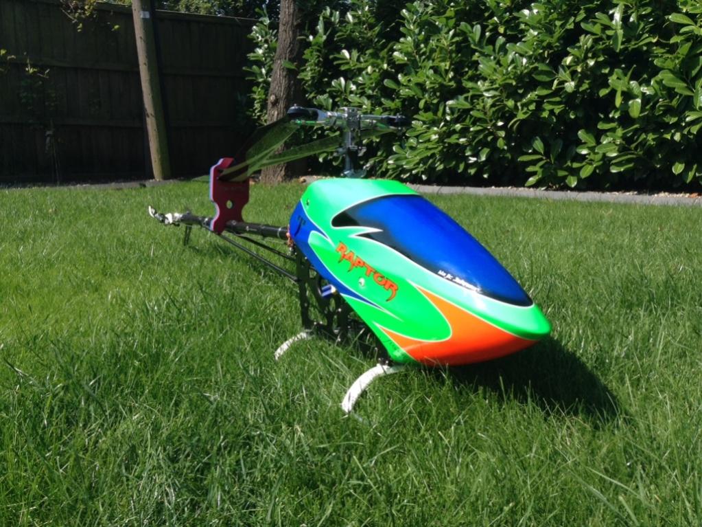

                    New cano arrived today. Went pretty block colours and super high viz orange. E820 cano's hard to come by so gave Fusuno a go and very decent job.
                    MJ
