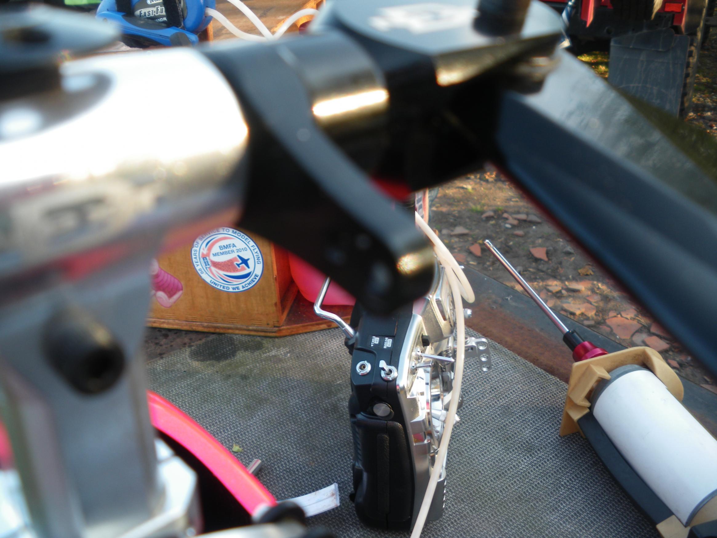

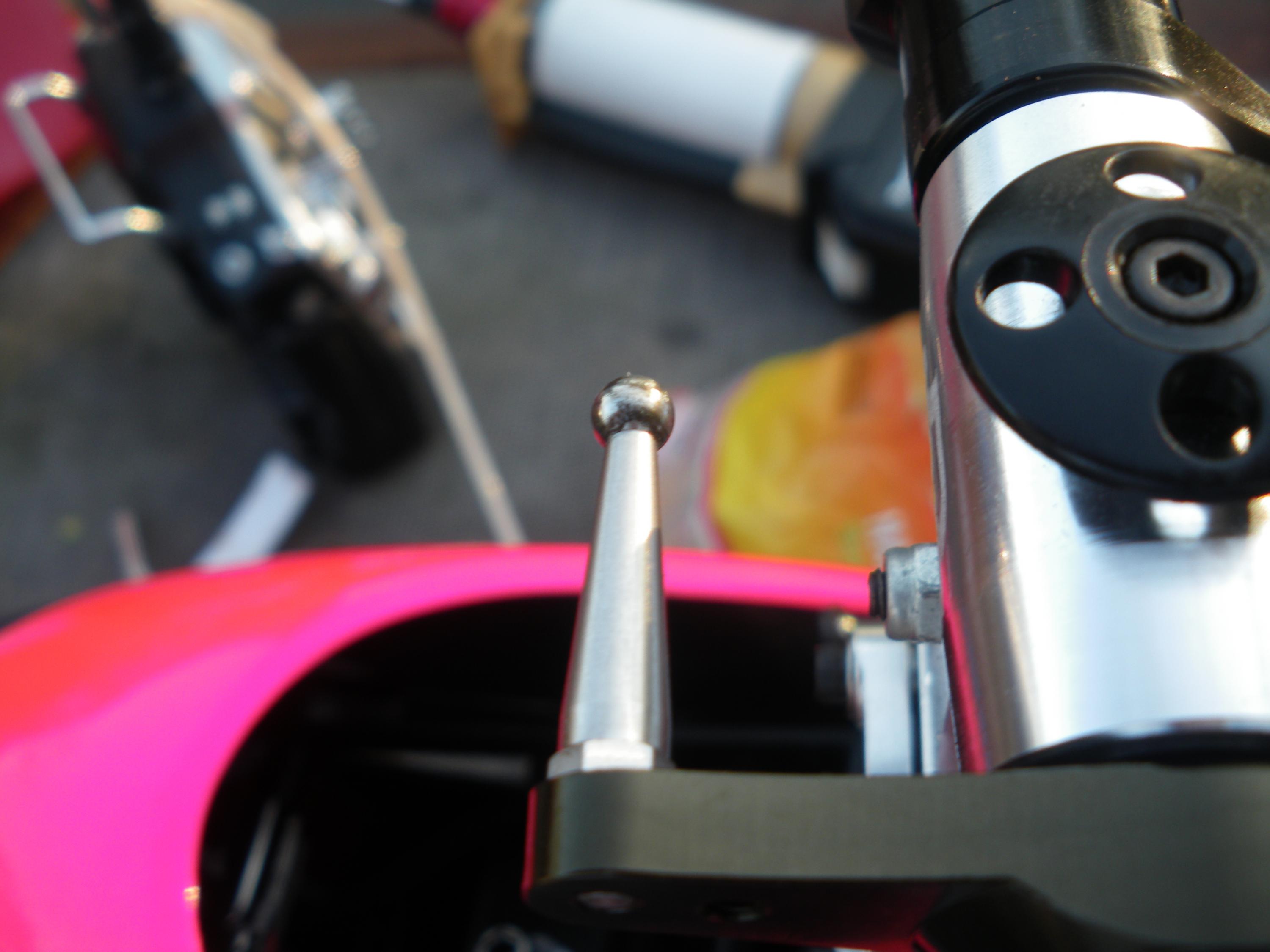

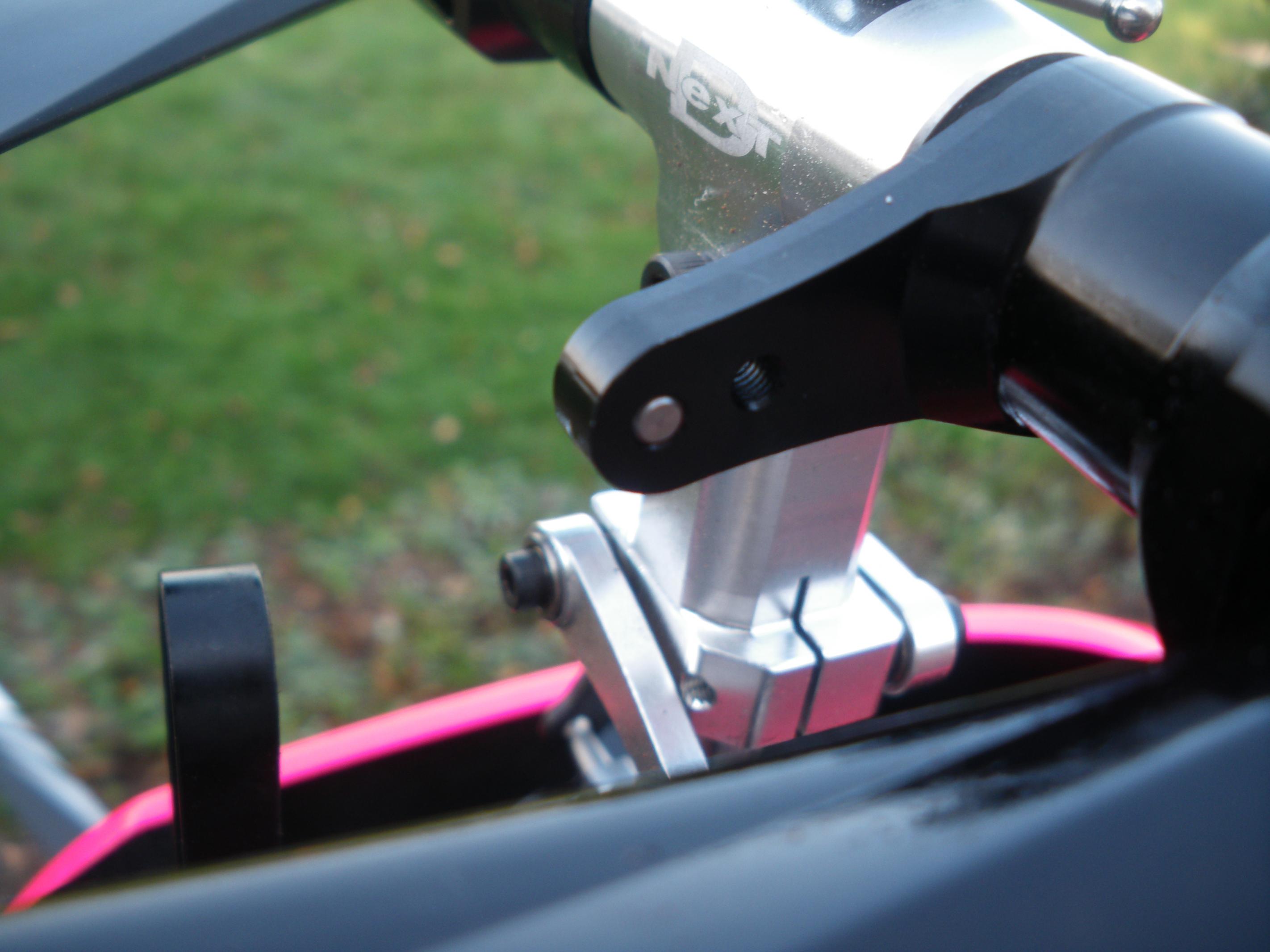

          Ps incase anyone is confused what broke here is the pictures and before anyone askes this Rave has never been crashed.

                  Is the new design thicker then,say M4 which is what it should be.
                    ok the new design is still M3 (I think) but you drill out the blade grip and a bolt goes through into the ball.
                    I removed the other ball of the other grip and its threaded down to the base and then wasted down to about 2MM (ish)
                    no wonder they are snapping.
                    hope this helps X Rachel

                            A turned part with a male thread is always a lot weaker than a bolt. The end of the machined threaded part is a big stress raiser, particularly if it is undercut to screw fully home into a square edged hole. Better to do without the undercut and chamfer or counterbore the hole on the blade grip.
                            The female thread and bolt will be much stronger (depending on the screw used of course). Its also cheaper to produce!(female theads are cheaper than male threads).
                            I think the manufacturers are just learning how much extra force gets onto the blade grip with flybarless helis. If you ever tipped the heli and hit the blade tip Rachael, its might have put unseen (and unseeable) damage onto the ball post. Previosuly this shock load was lost in the flybar tipping about or breaking the mixer arms.
