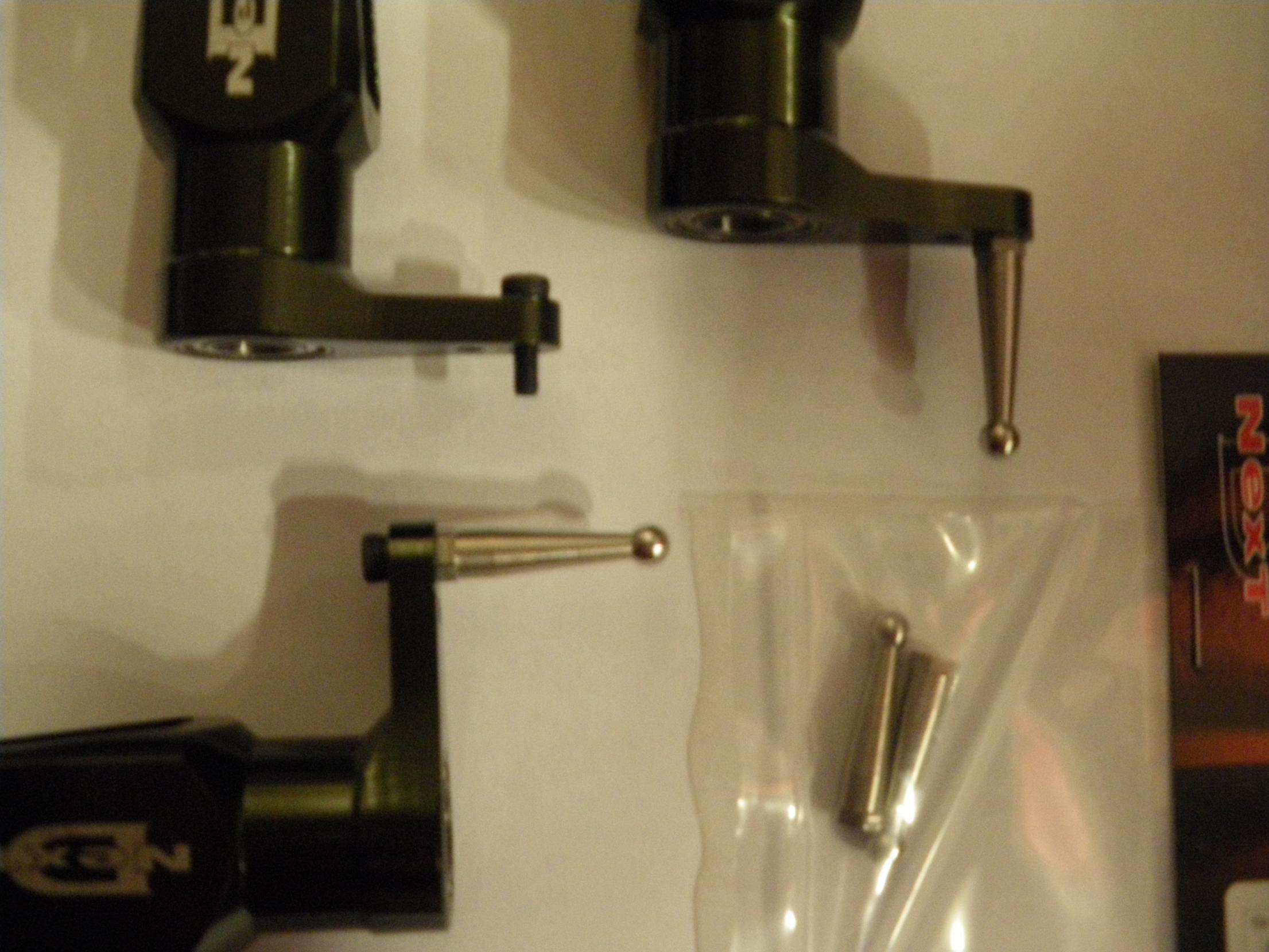

                            Rave ENV lade Grips the cure.
                            Ok parts arrived very quickly from Fast Lad :-)
                            you need part no ND-YR7-AS1087
                            They come with two sets of bolts one for the thicker blade grips like mine , and two shorter bolts to use with the other style blade grips which secure the blade grip ball with a nut.
                            I did NOT drill out the arms as the supplied bolts were not shouldered so drilling is not needed (no instructions supplied )
                            I then screwed the ball on to the bolt with thread lock.
                            Job Done !!!!!!
                            I should add I received a reply from Nicola at fast Lad who explained that Cye constantly develop the Env and my failure was very rare ! Typical of my luck lol.
                            Oh I have also changed the tail rotor hub , part no ND-YR7-AS1008 as these have been known to brake too.
                            my picture shows
                            Top left the right pertrusion for my style of blade grip
                            Top Right the original blade grip ass (Change it NOW !!!!!!!!)
                            Bottom left the new style unbreakable ball :-)
                            Bottom right the new parts.
                            I hope all Rave owners find this informative and helpfull and I look foward to many hours of fun with Dave 2 .
                            Shame I had to find this out the hard way but the model helicopter industry doesn't seem to do recalls.
                            happy Raving all
                            Rachel
                                Job Done !!!!!!
                                my picture shows
                                happy Raving all
                                Rachel
                                That's a great post Rachel.... While I didn't have any problems with the stock arms, the new arms are simply bullet proof. CYE is always looking for improvements in their products to the benefit of us all.
