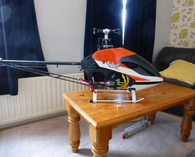

    What ESC is recommended for the Ballistic? I know CYE say a CC120HV ( should have kept the electrics form the 700e )
    Yeah pretty much anything suited for 12s 700 power should be plenty. It also depends on your flying style and if you plan to stretch it to a 700 size. Lots of people go quite a bit overkill because in reality your amp draws on 12s will be a lot lower than 120 amps! But if you fly really hard you can hit peaks in that vicinity. I was running a Castle Ice2 120 in mine and I keep meaning to look at the logs for the amp peaks but I know guys that have run 700 size F3C machines on smaller ESCs with no problems because the average amps will be a lot lower and they're not wacking in tons of collective or doing really fast changes etc.
    I've just fitted a YEP120HV on mine because I want to play around with some really low headspeeds and the YEP, YGE and Kontroniks have active freewheeling which is better suited for running at low throttle.

                          Just an update, as motors and ESCs have been discussed; I now have the YEP 120 on my Rave working perfectly. However, for reasons as yet unknown, I could not get the Helidrive motor to play nicely with any of my ESCs, so either they require very different settings (and I did try settings recommended by a couple people) or... maybe mine is just one that shouldn't have passed QC.
                          Sooo, what does work very well is the YEP with an Align 700M motor that I had rewound and new bearings fitted. In fact I was rather blown away by the amount of power available (and I'm using very ordinary Turnigy packs, so no super high C-rated things). Even with the heavy 5000mah packs the vertical climb is crazy and no bogging anywhere to be seen. This motor is a good bit higher KV, around 530, and the Helidrive is 480 so I may see about getting a 12 tooth pinion as I have a 13 now.
