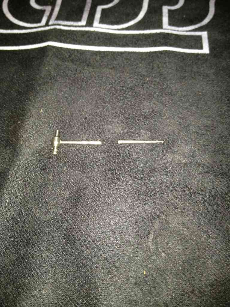

    I fitted a spin 8000 last night, today I get home before my wife and kids so decided to test it out before I get to the indoor club. Spooled up in living room, got it 3 ft up when bang all hell broke loose. The tail shaft ( lynx ) snapped right in the middle Click image for larger version

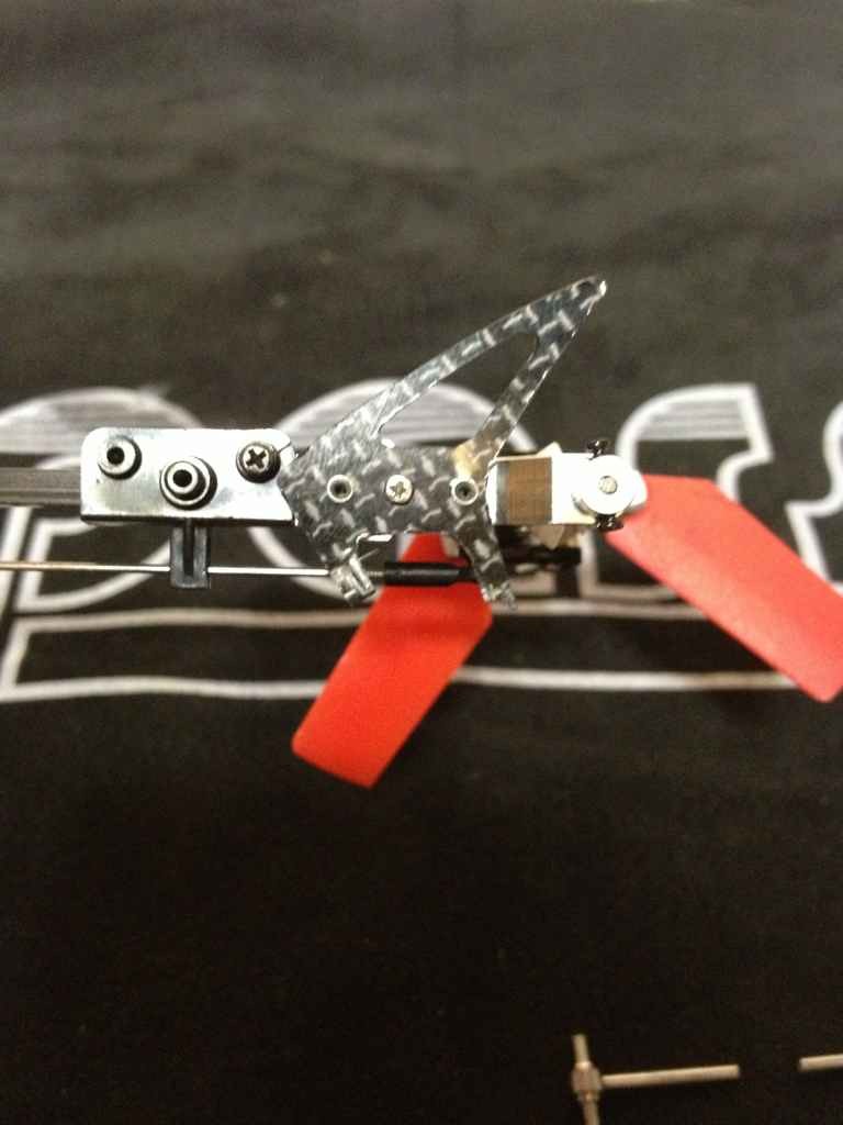

    To make matters worse I pulled full neg to get it down and the lynx tail fin snapped and disappeared into the abyss, my 1 year old son likes to pull himself about the place putting all foreign body's in his mouth. I've looked everywhere with a high powered torch just to be sure and its gone. It's got some nasty carbon splinters hanging of it I'm sure Click image for larger version

    My throttle curve was 90 flat when this happened on a 11t pinion so be warned people. You will need a much lower headspeed with this motor / pinion combo.

    I'm still playing with mine, 80% flat seems plenty

                Heathy, lynx have had QC issues with the tail shaft...
                I suggest you contact them and you'll most likely at least get that replaced

                      lol mines awesome but 80% with a little throttle mixing is ample for anyone sounds like it revved itself to death lol

                        80% flat is plenty imo
                        It was fast enough stock but it goes like hell now
                        I think it's much better than stock and definitely better with the heavy gens aces back nearly touching the servo rod

                          Tried mine today and glad it was up high o has the stock tail blades on and after a couple of pitch pumps bang. Te tail blade flew off along with half of the grip _=\ may order some metal ones so they can cope =p. it certainly seemed more powerful
                              I had the same last week on first flight with the spin at 85%,the blade flew out from the grip,cracked at the blade screw hole.Just picked up some lynx weighted grips from Quick to try
