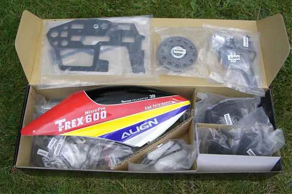

My shop called me yesterday to tell me my 600n was in so a drive to collect it was the order of the day and while Pegasus Models closes at 6pm they were more than happy to keep the shop open until I drove the 100 or so miles ! They closed the shop at 9pm as the wife and I left! Now that is service..........

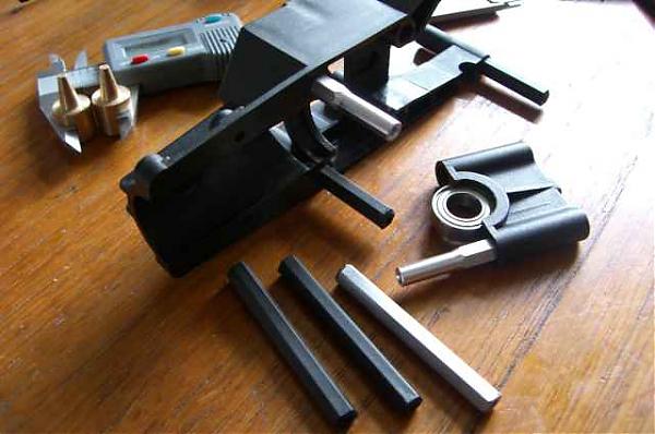

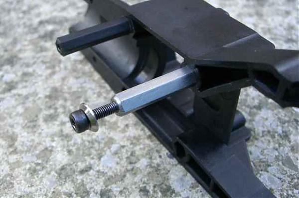

Having read the posts of the tail coming lose I have fixed mine as shown below. You just replace the six hex plastic spacers with metal ones drilled and tapped 3mm. I used ali hex bar but to make it easy for anyone without a workshop cut off some round ali rod and drill and tap 3mm and epoxy into one half of the tail casing. This will stop it turning while putting the 3mm cap heads in.
