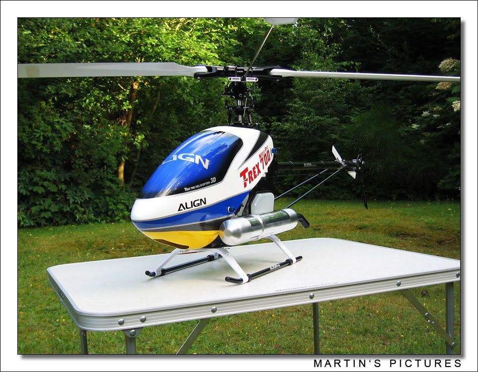

                            Well, I took a half-days leave today and did a bit more on the 700. She's pretty much complete now, with the exception of pitch and throttle curves and gyro gain etc. I've configured the Quark - my word that was easy!
                            Anyway, here's a few more shots:
                            Won't be boring you for much longer with this build!
                            Martin
                            Most of the Aligns, fair few Spektrum bits, bunch of Align & HiTec servos, OBE, VD & Bar.

                              Our pleasure mart, been pretty good so far
                              • very neat job on the wiring mart although i prefer servo braid myself.
                                so the maiden is this weekend then?
                                get plenty of fuel in cos your gonna need it,the 700 is addictive
