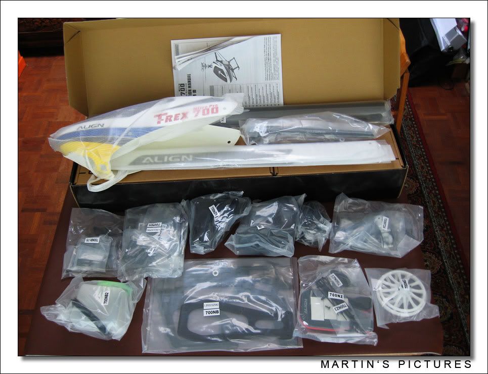

    Well, I took the decision to get started with the 700LE build today. Gonna do it piecemeal as I don't yet have everything I need to complete the machine.
    Here's what I've done thus far:
    What's in the box:
    The First Bag:
    Head:
    Seesaw, Flybar cage & Flybar installed
    It's going together really well thus far. Everything, quite logically of course, seems that much bigger and is requiring that much more degreasing prior to threadlocking.
