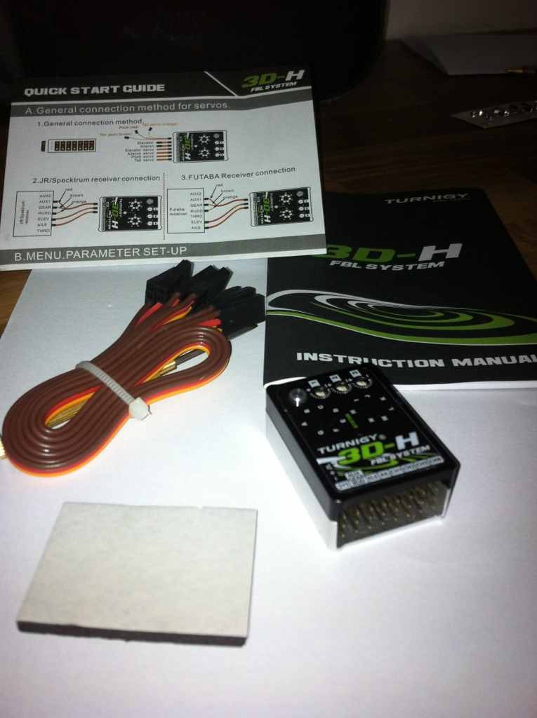

                              • Turnigy FBL controller
                                Well it's finally arrived, so what's in the box?
                                Looks pretty much the same set up as the beastx.
                                I will put it on the 500 this weekend and let you know how it performs, not that my flying will put any strain on it lol!
