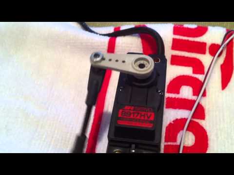

    I was playing around earlier with the Whiplash and a bluetooth unit for the VBar and noticed that something didn't quite seem right with one of the US model JR8917HV servos on the cyclic's.
    Every so often the servo would just stop altogether and moving the servo arm would then make it work again.
    Initially I could only get the servo to fail a few times in about an hour of fiddling but couldn't take a chance so got the servo tester out managed to get it to fail much more often.

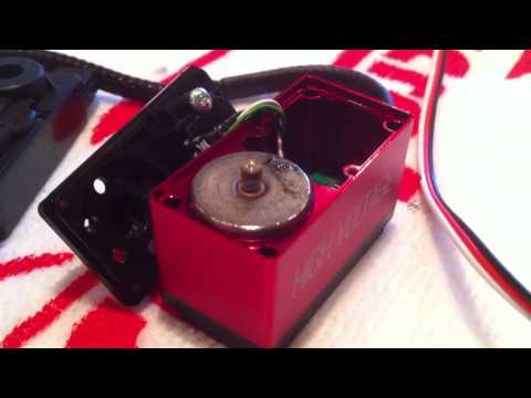

    Ended up pulling the servo out and stripping it down.
    Looks like the coreless servo motor is knackered.
    Anyone know if this part is available for a DIY repair?

          I have also spoken to Steve at Macgregors who has now ordered me a replacement coreless motor so I can repair the servo I have here and have a spare. Didn't discuss them doing the repair with a new motor being £37.50.
          As I have the servo fully to pieces after managing to get the old motor out of the heatsink case I thought I would give it a go.
          These motors are glued in and a solvent had to be used to release it.
