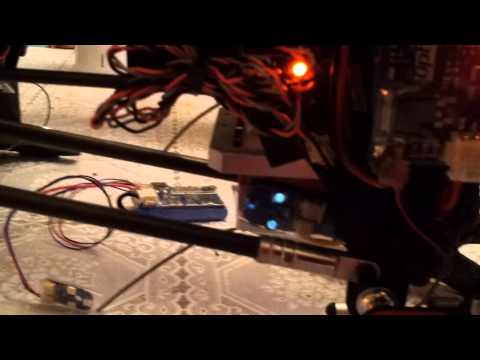

      quick question , got my second BUG today tested them and works ok but here the differnce
      BUG 1 - the external diode would light with kind of dim light , blinks when the main power is disconneded
      BUG 2 -
      the external diode don't light at all but blinks when the main power is disconneded
      should it light or not
      | Kraken : Neo | Atom 6HV : Neo | Vbct
      • I must have got a faulty gaurd , swap the diode but still BUG 1 the diode are on
        • have now tested with four different helis , can anybody using YGE confirm that there diode also stays on
          - heli with YGE 120LV ( not mikado version ) = the LED on
          - heli with WR BEC = LED off
          - heli with CC BEC pro = LED off
          - heli with YEP100 (clone ) = LED off
          I think this BUG don't like the YGE esc

              - heli with YGE 120LV ( not mikado version ) = the LED on = 7,5v
              - heli with WR BEC = LED off = 6v
              - heli with CC BEC pro = LED off = 6v
              - heli with YEP100 (clone ) = LED off = 5,5v
              • I think you'll find this is a voltage issue, not a YGE issue.
                Andy can confirm, but I think you'll see the LED glow a little at the high voltage you have set on the YGE.
                The 'alarm' part should still work fine and will flash if main power goes out.
                • Thanks Mark_T , did a test with the Hercules BEC and set to 7,5v and the LED will glow , at 6v the LED stays off
                  the question : is this ok or will it cause issues with my esc runninig at 7,5v
