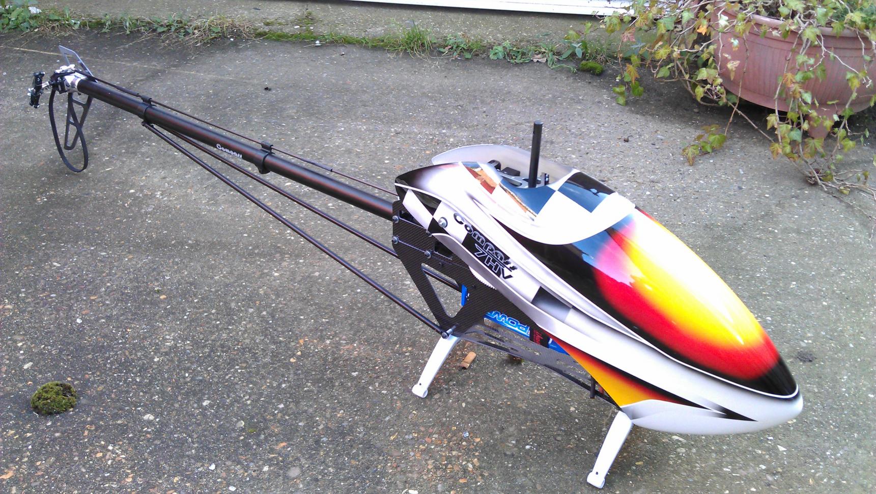

                            Got some build time on my 7HV recently.......it seems to have taken for ever to get the electronics and wiring right but im pretty happy with everything now.....juat done a quick "throw it together" to check C of G....
                            Should be ready for a few setup flights by next weekend......carnt wait
                            Ken

                              [QUOTE=kenny.c;778011]Got some build time on my 7HV recently.......it seems to have taken for ever to get the electronics and wiring right but im pretty happy with everything now.....juat done a quick "throw it together" to check C of G....
                              Ken
                              [ATTACH=CONFIG]35999[/ATTACH][/QUOTE]
                              almost there Ken...:)
