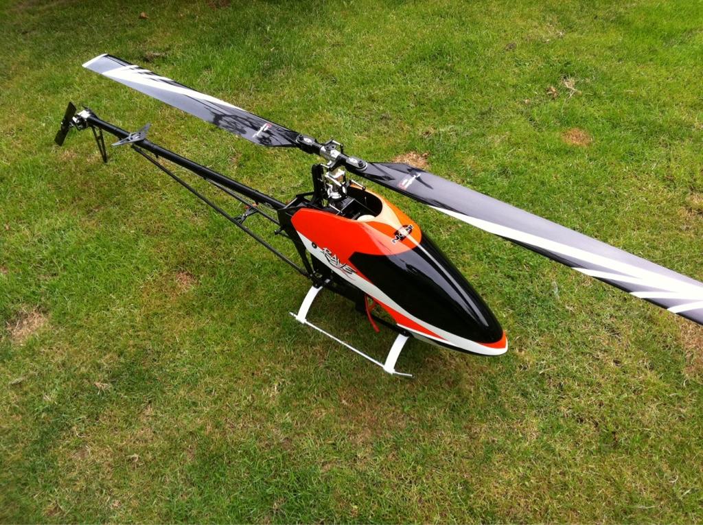

-Here's a pic from last week with a new Fusuno canopy (and the now dead and buried Hobbywing ESC)
http://www.rcheliaddict.co.uk/attach...e-p1010791.jpgLast edited by trillian; 04-02-2014, 01:06 AM.Kasama, Minicopter, Henseleit, JR, Shape, Beam
