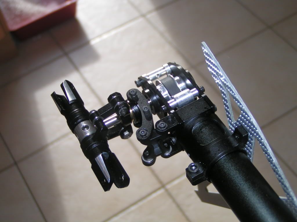

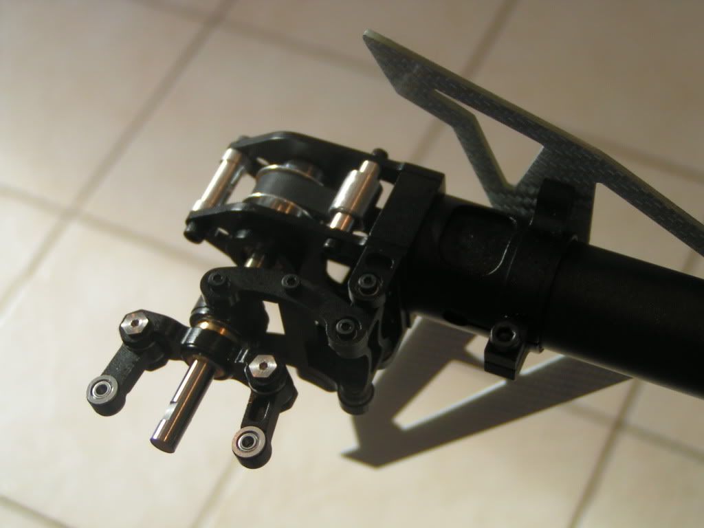

    One comment, looking at your tail assembly.
    The only thing on my G5 that wasn't pretty much perfect was a small detail on the tail pitch mechanism.
    There's a small amount of play in where the mechanism mounting bracket attaches to the r/h bearing plate. It's held firmly in place by the two screws that attach it, and the side plate to the tail boom grip.
    If you don't get this aligned correctly, you get some friction in the mechanism, and I found I needed to align it by trial & error, with the pitch mechanism installed.
    I then loctited and tightened these 2 screws, and aimed only to remove the l/h plate in future.
    It's possible this isn't an issue with the 550, but you may find the order you appear to have assembled the tail in doesn't help with this.
    Yes, it's th@ tw@ Scallyb@...

      Good point - it's a shame they didn't mould that plate into the RH housing so it can't be fixed on wonky...
      Mine took a few goes to get spot on too.

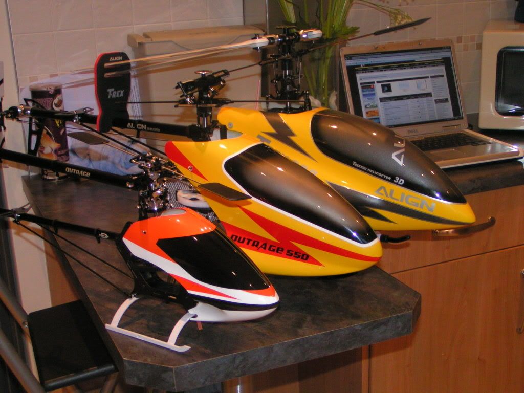

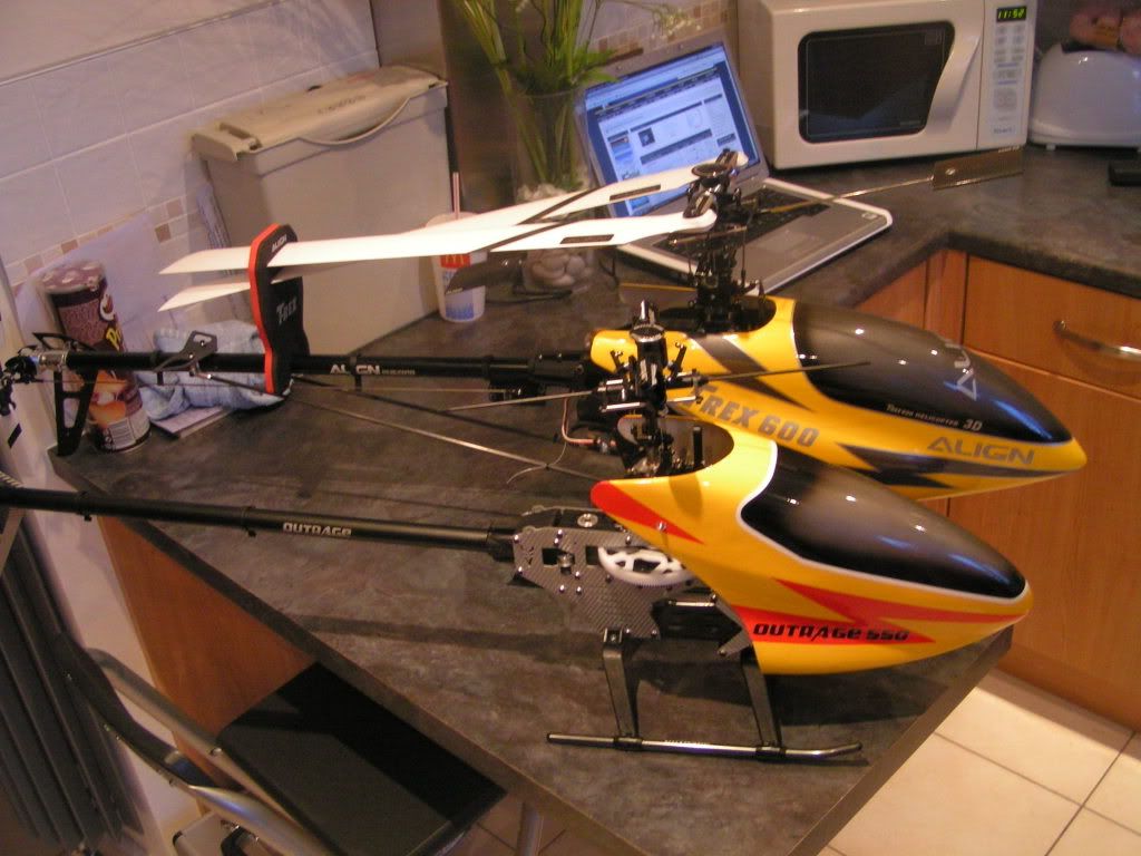

        Size comparison
        Just been building a 600 ESP and Rave 3D for a friend so took some pics to compare physical size
        Ray
        Logo 550sx Spirit System
        Goblin 500 Spirit System
        Compass Atom 500 Fly barred
        Compass Warp 360 FBL
        Some of them fpv quad racing things
        And an EGS. Many thanks

          The 600 esp looks fantastic , the rave looks the dogs dangerlies........................................ .....................................oh and outrage looks quite menacing.... all we need now is some new batteries and we,ll be well away
          well done ray ,your a top builder ( and flyer)
          logo 550sx...>>> not bad
          logo 500 bitsa..>> Needs a spirit fbl unit to complete...

            that mounting bracket is a lot easier to set on the 550, much more tolerance for it being slightly out.

                Yeah, but if they did, and if it didn't line up then, you'd be a bit stuffed.
                I guess aligning it yourself is a little tedious, but you do get to do it right.

                  Thanks for the 'heads-up'
                  Just installed the bits and maybe i was lucky but it was as smooth as a baby's botty first time....but thanks for the advice
