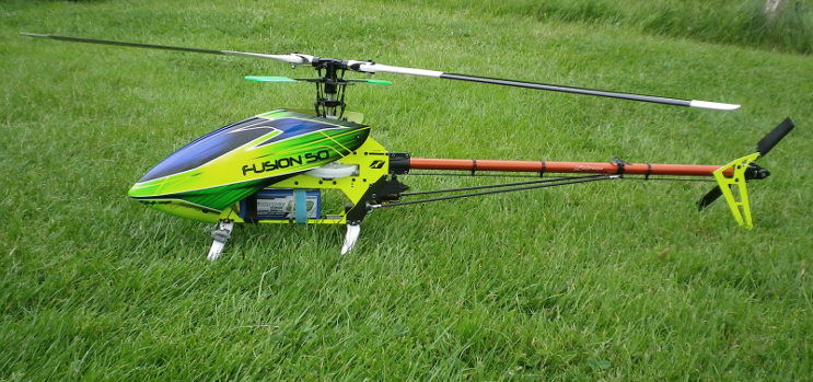

        Here's a pic of mine (did a swap for something else a while back so I no longer have it).
