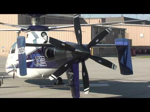

      Ben,, why not convert the TDR to coaxial then fit a pusher prop?
      see you tube clip
