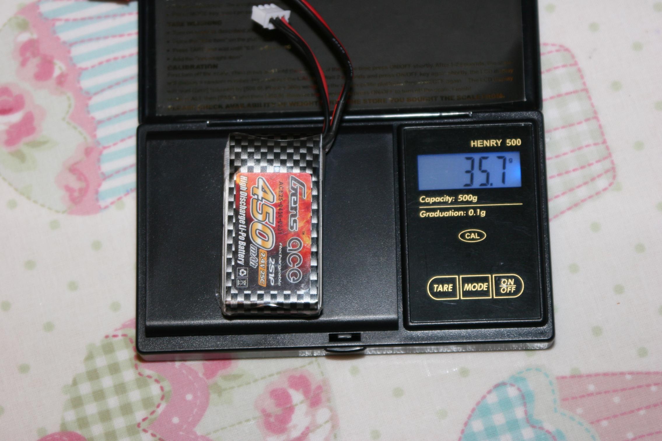

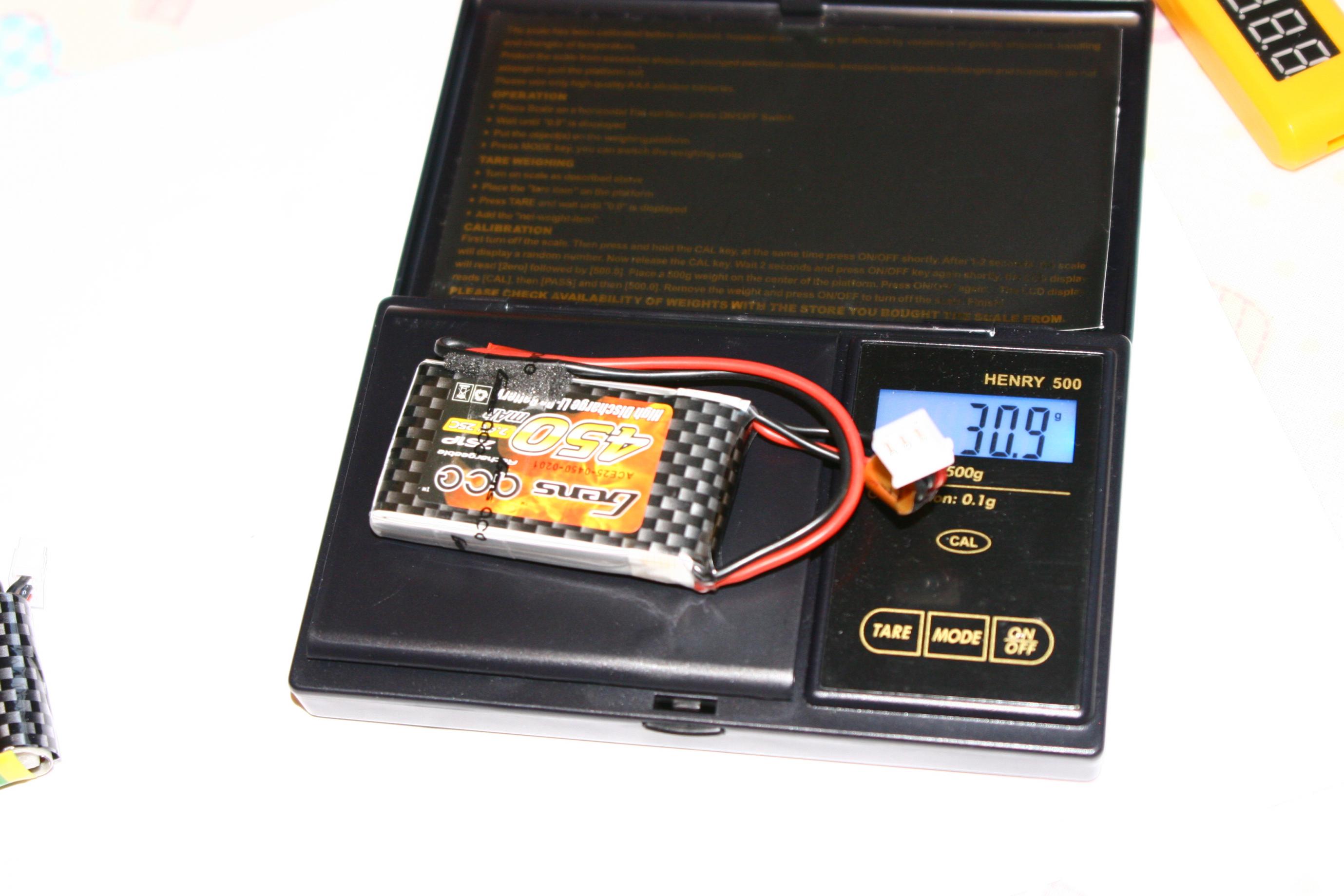

                  Finished one tonight!
                  From this:
                  To this:

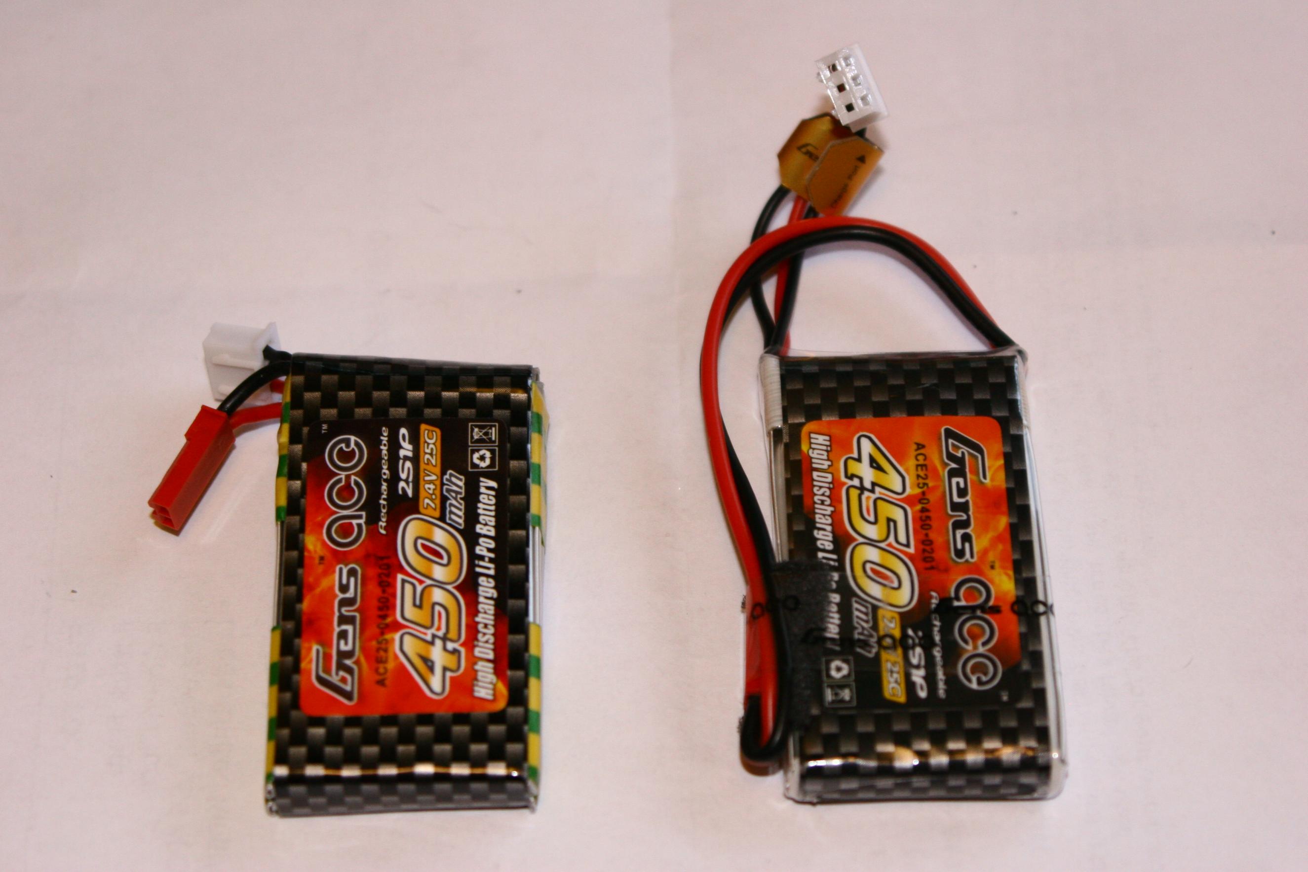

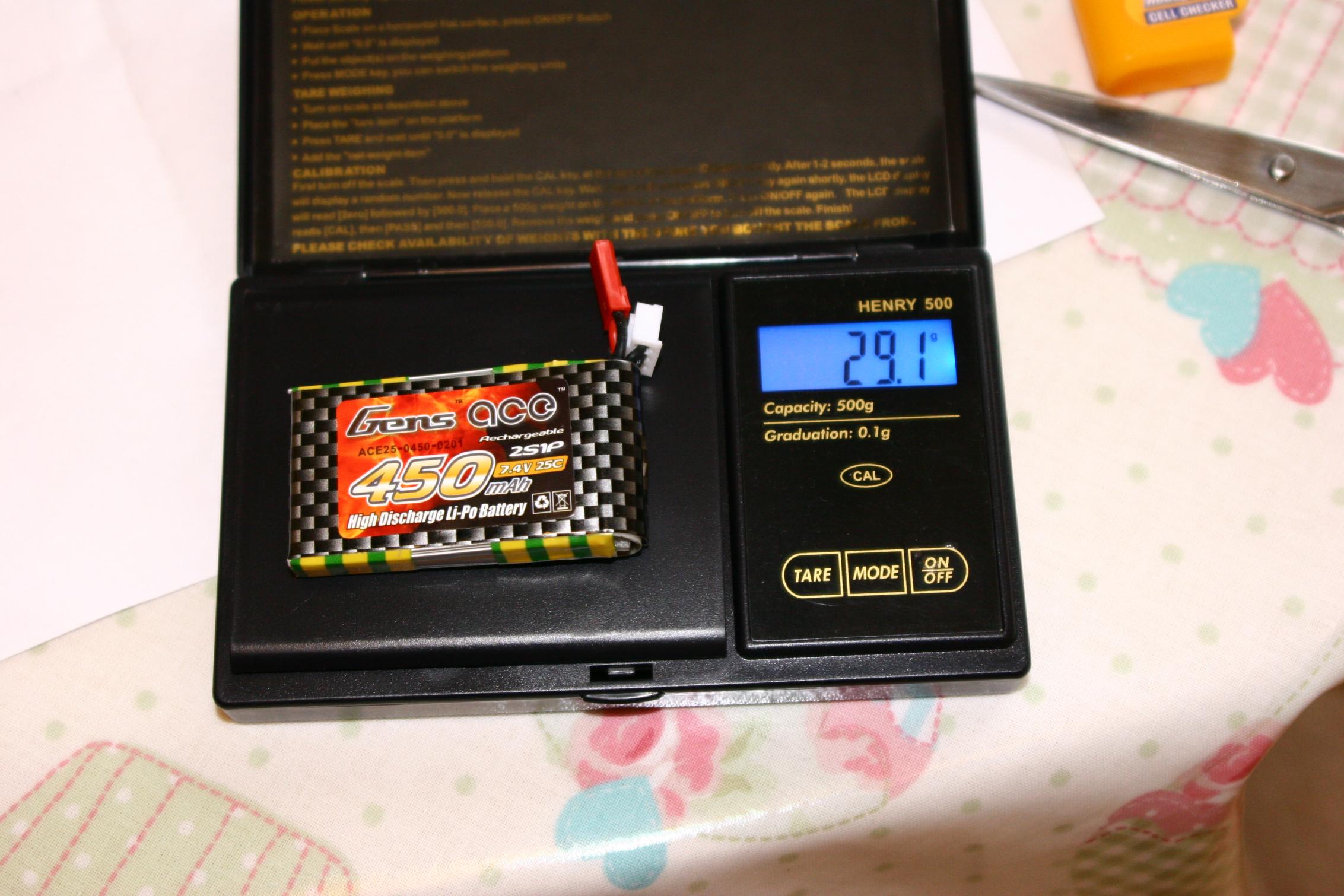

                  And the 4 more I ordered the other night arrived today. Guess what, the new ones do NOT have plates on them anymore and definitely thinner:
