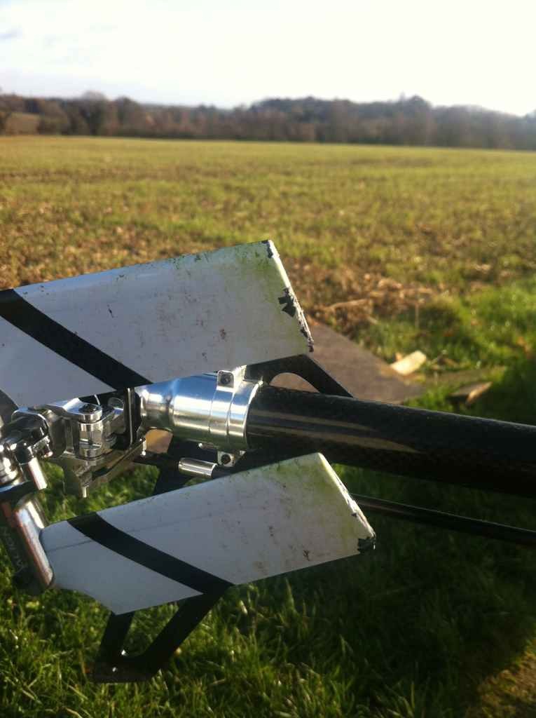

Annoying thing is what I had to land on, and the result!
