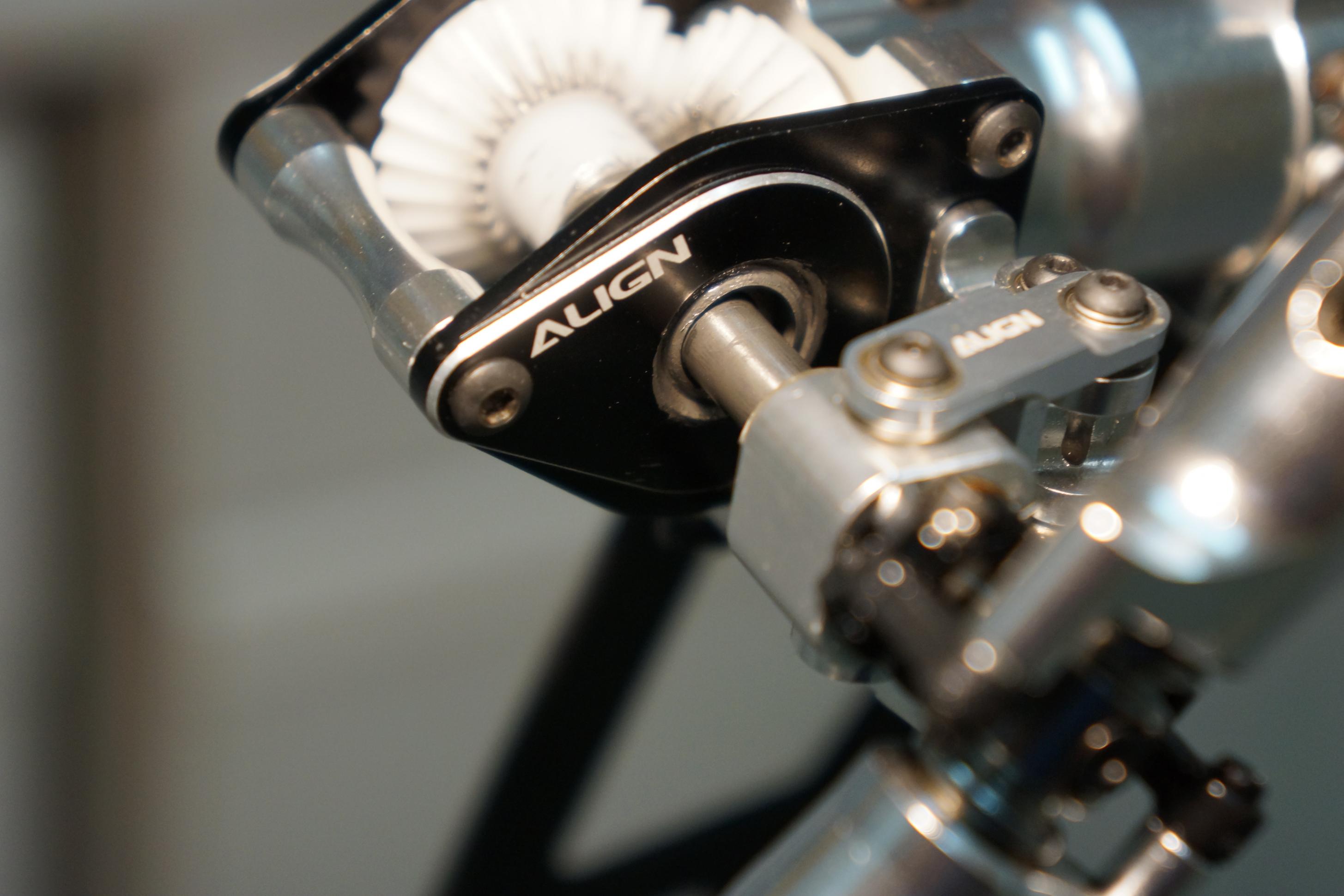

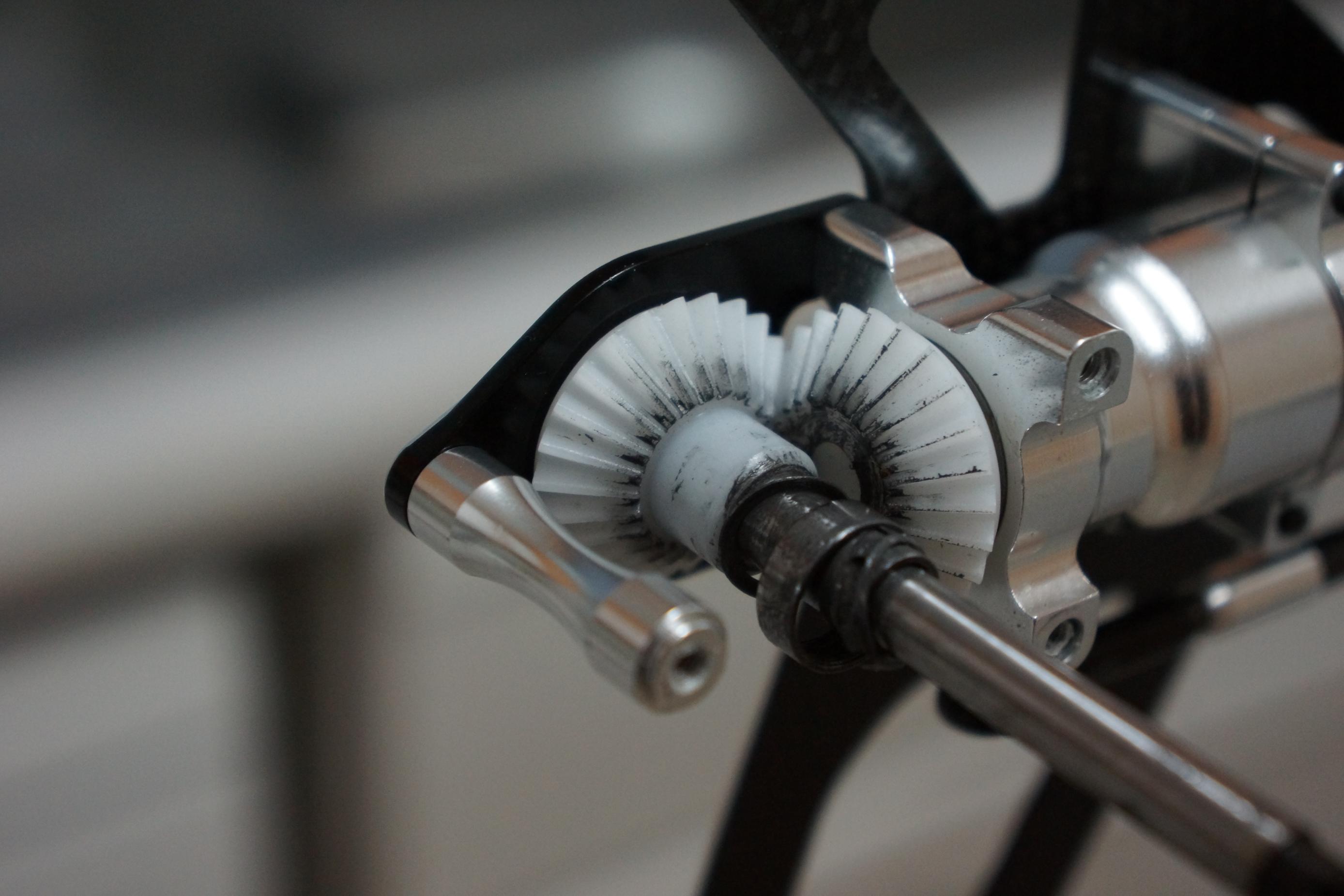

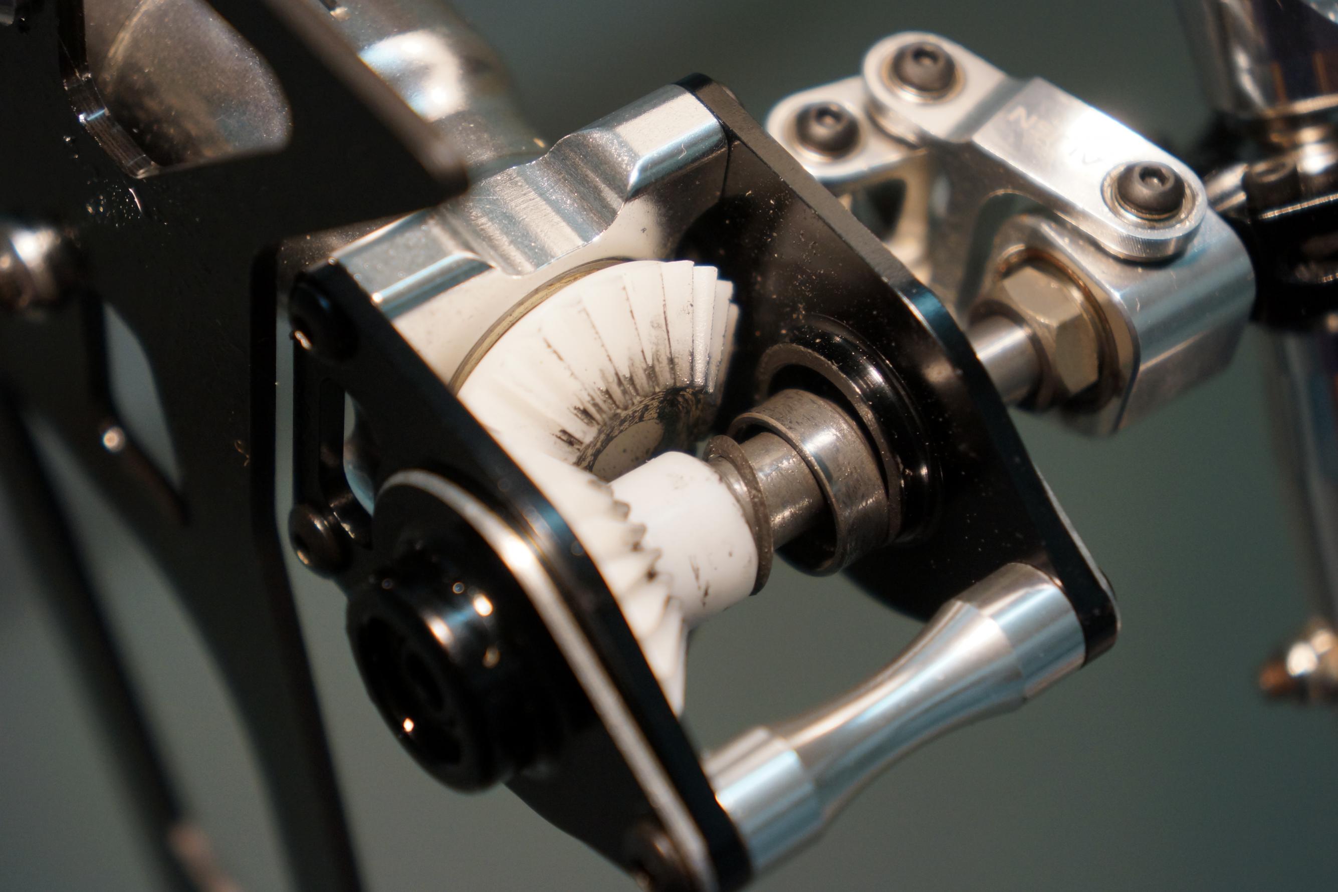

    Flying my YS120 powered T Rex700 yesterday morning and managed to get two and half tanks though it before getting an uncontrollable tail wag.
    Managed to get the heli down and on checking found this.....
ID:	1911956Click image for larger version
    These tail bearings were changed 12 flights ago......bit lucky this time I think.

    Very nasty well done getting it down in one peace....
      >> As we all know Align bearings are seriously crap
      are they? The other side looks good as new
      Seriously, the pictures speak for themselves, but I still use them in other helis, because cheap. Usually they get no chance to die of old age.
      BTW, I would most definitely change the tail shaft, even if it's still straight, wouldn't want it to break after that abuse.
      Woohoohoohoohoohoohoohoohoohoohoo -Barbra Streisand
        Yeah,looks like a new tail shaft and a pair of good quality bearings.
        I can't actually get the inner bearing sleeve from off the shaft - it's well seized..
