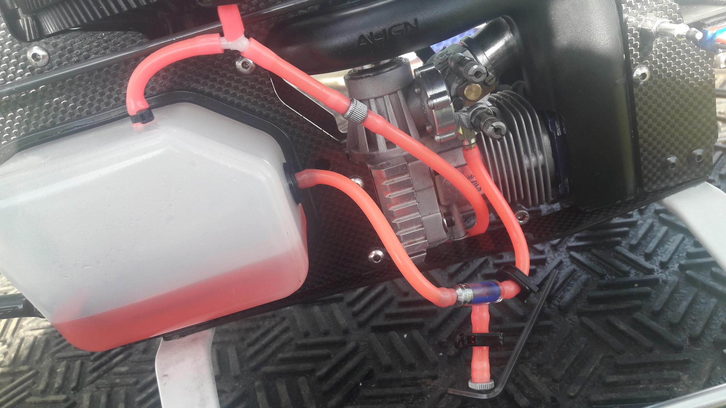

                  Heres a pic of the setup, I cable tied the pipe at the top of the tank as it seemed to leak a bit.

                    Looks fine Chris, odd that you were getting fuel out of the top nipple though as the pressure should be down
                      I'm guessing that you do release the tank pressure after flying ?
                        Unless you can actually see fuel pouring out the top of the carb its more likely to be be burnt fuel that congregates in the fan shroud as the fan sucks in the smoke.
                        This will drip if you're on the rich side of the tune.
                          Yeah otherwise it would make quite a mess when i tried to refuel, not that I have done that...
