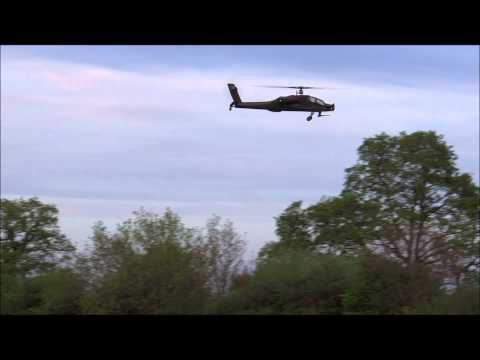

    I have finally managed to get time to put the mechanics out into the Body and give her its first flight although its not finished yet still needs the Pilots and Rocket Pods installed.
    Video.

              Flying Last Night

                Superb!
                sigpic thank you.
                  Nice....
                    Very nice.
                    Do you have any plans for retractable undercarriage?
                      Allegedly, they are bringing out the Superscale 700 size Apache in August, and definitely got my eye on it for a first scale project.
                      The fus quality looks really good, is that the case?

                        Thanks for the comments.
                        It's taken a while getting the correct FBL unit for a 4 blade head and a workable setup.
                        Mike to my knowledge the Apache does not have a retractable undercarriage happy to be corrected.
                        I got the Fuz 2nd hand although it was new I and would have taken it back the undercarriage mounting points needed work to make the bent struts to fit.
                        The Exhaust ports were missing part of the moldings. It was original desert color which was a pain to paint over.
                        The Trex one way bearing would not fit in to the supplied main gear.
                        The raised tail needed a bit of work.
                        So as long as you don't mind the work then its worth it.
                        A 700 would look the Dog's

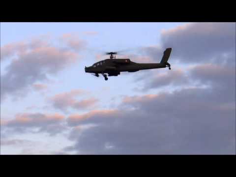

                            Video taken at dusk the other night.
