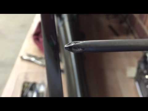

      Hi guys, let me explain this slightly as theres a few people going off track and i dont want Roban taking all the blame here...
      Bear with Phil as hes not up to scratch with all the terminology (no offence mate) As most of you know i'm not really a scale model flyer but i have dabbled once upon a time
      Right... firstly there is/was no tracking issue on the head or tail. The blades track perfectly and did so from the word go. Vibration originally came from the front of the fus and was around the rocket pods area of the machine. Understandably really and i would expect to see flex around these types of parts anyways. Phil has recently stiffened this area up after we test flew it. Since then that has cured alot of the fus vibes but also transferred alot of it to the tail area of the model. As you will all be aware the Apache has a 45 degree bend and raised tail rotor section. This is where the vibration is currently at. That whole section is vibrating and causing what looks like tracking issues on the tail but its actually just the raised tail section flexing. Phil has recently balanced his main blades like i originally suggested. This has now cured 80% of the vibration issues on the tail.
      After closely inspecting the tail blades he seems to have bad blades. I'll upload the video shortly.
      Bud sending him some new tail blades by all account.Hopefully this will put the remaining vibrations to bed.

        Heres the video of the tails... i have not seen this in the flesh but the obvious answer is something bent (ie tail output shaft/hub etc) or the tails are faulty/mis-matched.
        Lee
        www.raptoruas.co.uk
        www.lee.rcha-uk.com
        www.gensace.de
