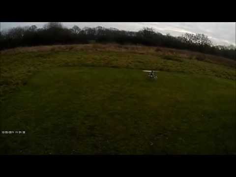

    I have a Trex 500 with a Align FBL head and a Beast X that has been flying fine as a Pod and boom.
    I put it in a RC Aerodyne Airwolf 500 fuselage but when I try and hover her it wobbles.
    I replace the main shaft and main shaft bearings but I cant get rid of the wobble.
    This is a short video of the problem
    <sub>
    Anyone had this problem ?
    Stuart

    More headspeed or softer dampers now you have the extra weight of the fuz, hard damping is not required.
    Happy Flying! Thanks - Dave

      where is the beast x situated now?
      just wondered if it was causing any issue
        The Beast X is in the same place as it has always been on the block on the tail rotor gear at the back of the main frame.
        Stuart

          Would using Fly Bar blades have the same effect ?
          Stuart

            Hi,
            As already stated try upping or lowering the head speed. You now have a resonance by adding the body. Increase or decrease the head speed to move the frequency of the resonance.
            You said it was flying ok before adding the shell so I suspect this is the problem if nothing else has changed.
            Hope this helps.
            Mark.
              Have you tried lowering the cyclic gain (pot no. 1)
                Adjusting the cyclic gain will have the same effect as adjusting a flybar so no it wouldn't make a difference.
                i would also up the head speed as everything has to work harder with the extra weight, and also read the beastx manual for adjusting the cyclic gain as its responding out of time.works the same as your tail gain, but for your cyclic control, and i think its adjuster no.1 on the unit from memory.
                will be a cool little heli when you get it sorted!
                  Hi all, I changed the dampers for softer ones (the old ones seemed quite soft any way) I also changed the Pinion to give me a higher head speed. Wend to a fly lunch time but it has made no difference .
                  So I will put it back to a Pod and Boom setup and fly it to check there is no issue the the mechanics.
