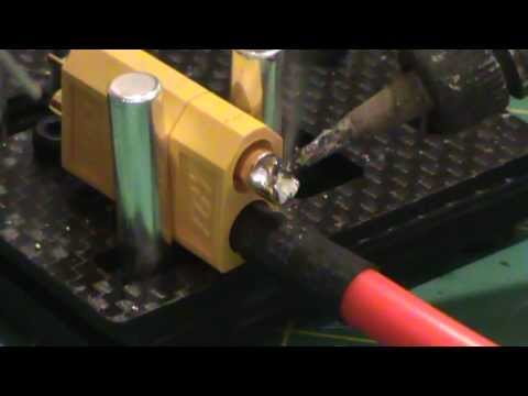

        My RX lipo has a xt60 connector on it so could do with something like WaveyDavey suggested but a different lipo connector. Might just have to soldier my own as I have all the stuff I need, if I can't find one?

            Thanks Waveydavey, that's a very kind offer. I'm going to try soldier it myself and see how it turns out. If it goes really wrong you might be hearing from me

              Let me know, in the meantime take a look at this XT60 sodering video
