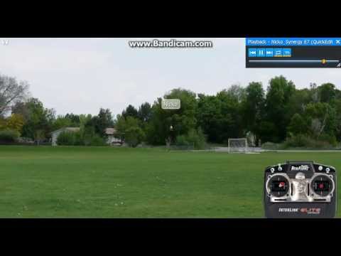

                    I did you a short sim clip last night then forgot to add it here for you lol
                      Like it Nick, exactly what I needed cheers.
