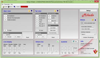

    My tail stop is kinda soft on the left side (nose going right). (slight bounce when I stop but nice and firm on the opposite)
    Now, some people have said I'll need to turn the link rod a turn or 2 to adjust it mechanically... BUT WHICH WAY? Do I do this to give more space for the tail left turn (nose right) or do I leave more space for the opposite (nose left)?
    Or should I forget this and go into the expert mode and fiddle with the precomps?

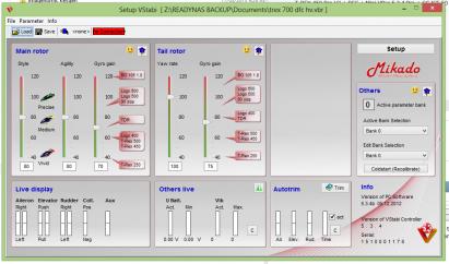

    my tail gain is at 70 on vbar menu.
    At the moment, my link rod is exactly what Vbar states on its menu - with the tail pitch arm positioned square giving me 2-3degrees of pitch
    anyone?

        Hmm, I might need to go to the field to properly get Optimizer going first then before I fiddled with any mechanical or advance options do you think?
        I just hovered in the front house yesterday and tweaked a few settings (I know it's probably not enough of a test)
          If you've set it up as per the manual 2-3 degrees of offset i would leave the mechanical setup as is... particulary if one way works ok.

              As above I would not play with the mechanics. If you have the couple of degrees and linkages are smooth. Get to the field and try the optimiser first

                Ok - I shall take it to the field and will try. Yes my mechanical setup is as per the manual. square linkages and 2-3degrees of pitch.
                First time I took it to the field (only just got the heli a couple of weeks back and only just took it up on its first flight last week),
                current settings as of yesterday:

                  Also I notice your optimiser is reading 45/99 it says in the vbar manual that a number over 80 points suggests too much or too little mechanical compensation. HOWEVER i have found this isn't always the case as improving the other settings also helps to sort this out.
