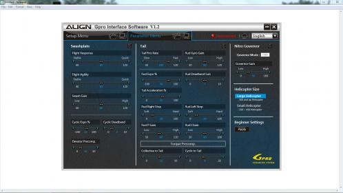

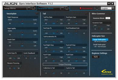

    Now I've got my heli's perfect setup with Gpro including tail all that's left to do is slight speed up of tail stops without loosing any other feel to the tail.
    What is the best parameter to use that will work on firming up the stops...?
    Can't seem to upload the pic with tail parameters so have to have another once I'm home.

        Hi Ian its my 5 & 600, this is where its difficult for me to explain, doing ie circuits the tail tracks perfect with my stick inputs the tail also holds perfect with 3D maneuvers but if i release the tail stick quick i don't get the sudden stop but tail still tracks perfect if that makes sense.
        There's no bounce on the tail & if i pitch pump tails holds solid but as soon as i play anymore with parameters its like its effecting what ive already got.
