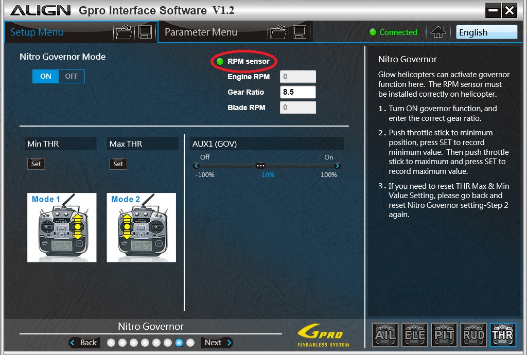

    In the setup menu the indicator next to the RPM sensor will turn green when sensor is on the magnet, and red when it is not.
    Hope this helps

      I'll check now, I was cranking it to change but didn't notice it turn green.

        Not sure how fast the software updates the indicator, best way to be sure is to turn the engine slowly with your finger in the fan, this way you can also check you only get 1 activation per rotation. (If the two fan magnets are wrong you may get 2)

          Thanks Paul, I've just turned it very slowly & it is switching green, software is not sensitive enough to show green when cranking.
