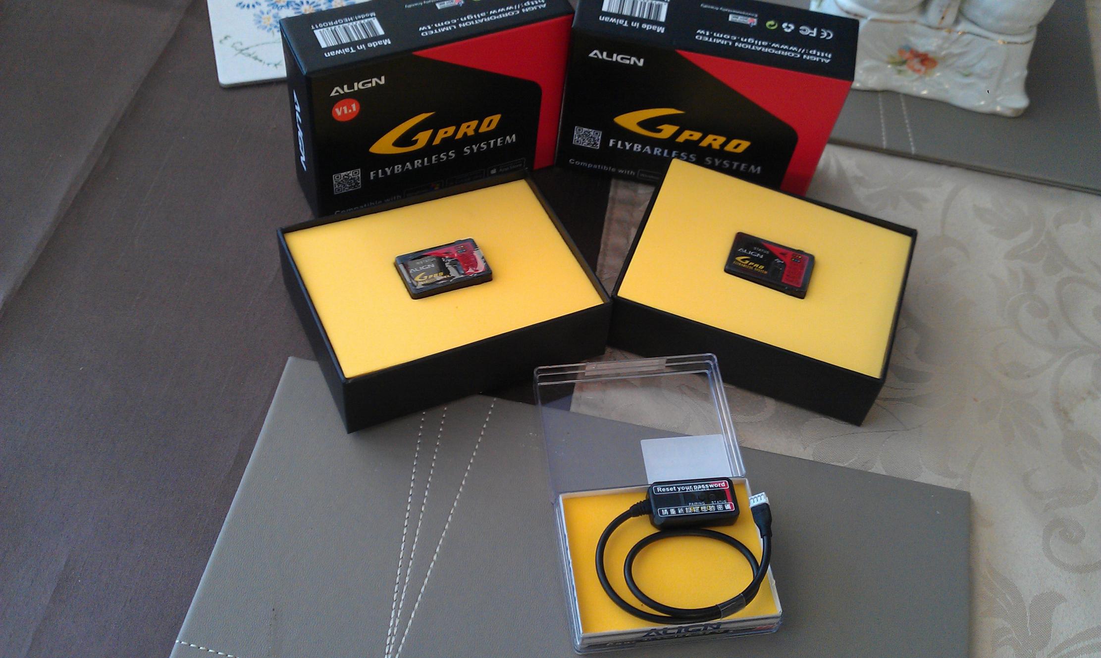

    Got my Gpro's in the post today so thought ill start at both ends of my fleet so ones going on my 250dfc & the other on 600e and if im liking it ill do my other heli's so looks like there be few 3GX's on the for sale very soon.
