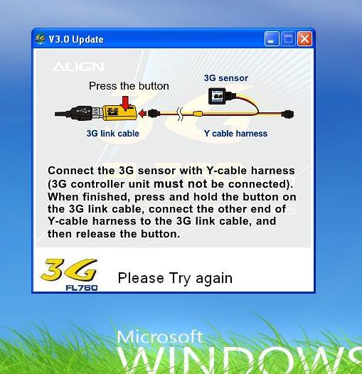

    I'm wondering if anyone can help me? I'm trying to update my 3G to V3 and everytime I connect the sensor to the dongle I get this message :-
    Please try again, and believe me I have! It did work once, so now the sensor is on V3 but it failed again when I connected the control unit so that is still on V1.
    I have tried different versions of software, fresh installs, restarts, different usb leads and different leads to connect the sensor to the dongle. Both units are new, fresh out of their boxes :S (3G and USB Link )
    I suspect that the dongle is at fault as the click button on the back doesn't feel 'right'
    Any help would be very much appreciated.

        Is the button on the dongle making a nice klick when pressed ?

          Well, it does click, but it doesn't feel very positive - I have found a second one to try (Huge thanks to Bikerflier )

                Thanks to Bikerflyer, I now have a replacement usb dongle and I am pleased to say that I have solved my update problem - Duff USB adapter Thankfully I bought it new so it's about to be returned!
                Thanks for your input guys
