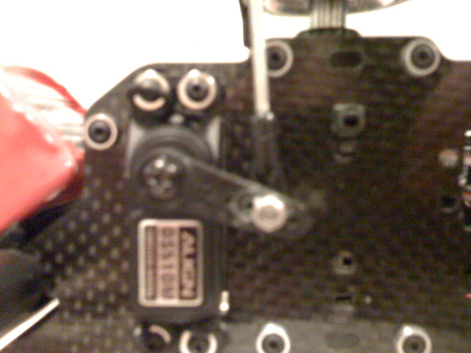

I have just setup Trex 500, but I could get the pitch in correct position. I have trimmed pitch to 0 degree when throttle/pitch at half stick, and then try use swash mix to adjust pitch to correct range (+12 degree ~~ -12 degree). Here is the problem, I can adjust positive pitch to 12 degree and then my negative pitch only at -10.5 degree. So what I did is increase the swash mix to keep positive pitch at about 13 degree and then my negative pitch would be just under -12 degree.
My question is would that be ok if I keep like this or should I adjust travel adjustment on my Tx to limit positive pitch at +12 degree. Or may be some other alternative way I can make this right.
Many thanks
Rui
