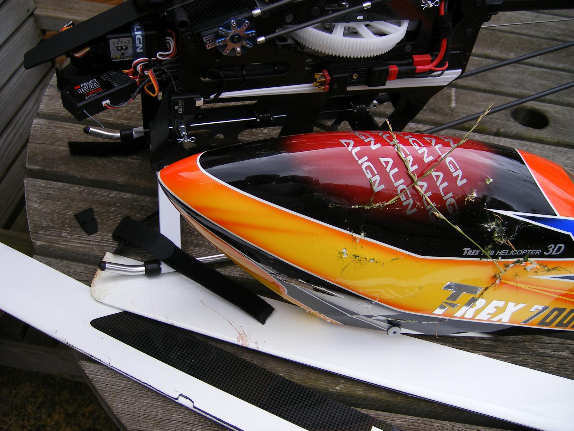

    Just come back from the field and the maiden flight.
    Managed to get almost three packs through the heli and this was more an attempt to fine tune the system.
    Hovered up ok but needed the gain on the main unit turning down slightly.
    The tail also needs a bit of a tweek but unfortunately I ran out of luck
    While in a quite high climb out the rudder servo screw decided to back out and one ultra fast piro later she hit the ground.
    Throttle hold saved a lot but still not very good on a brand new heli.
    Blades,canopy,main shaft,feathering shaft and links,velcro battery straps,front radio tray,boom and torque tube and maybe the receiver.
    The later was found with the case in half.
    At least it was flying OK - for a short while

      Oh shit, this is the 2nd 90 I have heard go in today.
      Hope you get it back in the air soon.
