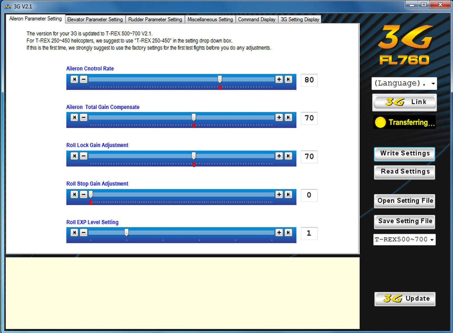

                            I then procceded to apply the 500~700 settings to my unit which as I said started but never seems to finish.
                            Take a look at the screen dump below, In the text it says they are applied, On the right it say's "Transferring.??
                              Sorry for the slow reply. Trying to multi task. Cooking dinner and having a beer whilst watching BGT.
                              OK. After updating both main unit and gyro unit, open up the 3G software via the start menu. Ensure both units are connected to the y lead and then to the dongle. Power up the heli (Tx & RX) using your normal receiver pack or flight pack.
                              Click the link button on screen and the "connected" green message should appear. Click on open settings drop down and choose Trex 700. Then choose update. Should only take a few seconds.
                              Once completed, power down the heli. Remove all cables and replace the original signal cable between the gyro unit and the main unit.
                              Power up the heli as normal (Tx & Rx) and go through the set up as per the original 3g set up on the main unit. (50% stick, Elevator-Aileron etc etc)
