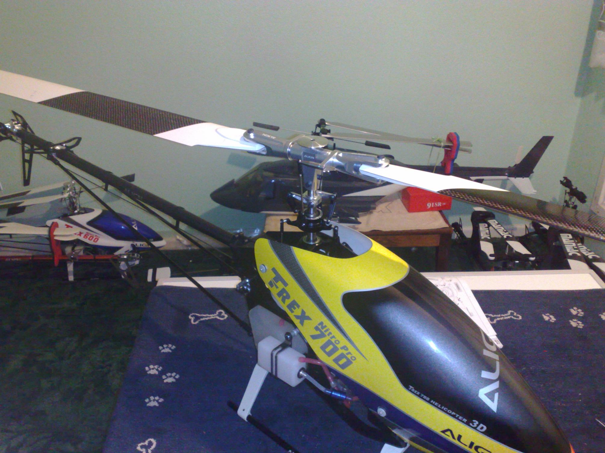

    Just started a separate thread showing any main points of interest or concern with the Align system on my 700N.I wont go into much detail as much better qualified people than me will no doubt be doing this,just covering the main points.
    I am fitting it tonight and will be flying it on Sat and Sun if it survives.
    I am going to use my previous although limited experience gained from using the V bar and will draw comparisons between the two all IMHO.
    I am not going to use the supplied sticky pads but will use 401 pads as these work very well with the Mikado sensor even on a Raptor with no boom struts and lots of vibration,also use them on my 600N V bar.
    Will also hot glue all the plugs to the sensor/controller.
    With Matts help tonight i am going to get the swash level thru the full travel and use subtrim and atv where necessary to achieve this.As long as you re do step one again which is the initail sensing this is fine.
    The mechanical setup is absolutely essential to get good performance.
    Nothing to report on the quality of the parts and system,all looks typical Align and of pretty decent quality indeed.
    I am running the Align 2 in 1,an Auorra 2s 4400 lipo,9255 servos.

                Update
                All fitted and ready,many thanks to Matt for the assistance with it,very much appreciated.
                Ok this is how i have set it.
                Firstly put it into setup mode and checked all the servos were working the correct way which they would be as long as you reconnect the two front servos the right way round to how you had them,Aeileron/pitch.
                Then i got the horns as close to 90 deg as poss at centre stick,when you are in the first stage of setup mode the control loop is inactive meaning if you move the heli the swash wont react not ideal if you are trying to centre stuff.Mikado has a setup option selectable in the software so V bar fliers know what this does and will be familiar.
                Next we used the leveller to get the swash level and servo arms totally correct with subtrim.Top and bottom swash showed a slight inaccuracy in one servo so i used the atv to dial this out.
                Once done i powered down and re initialised with the setup button pressed to re enter setup mode and to store these new neutral points etc.(this is my interpretation of the instructions)
                The next stages,setting aeileron travel limit and the direction the swash reacts to the model when tilted were dead simple same for elevator.
                The suggested rod lengths were pretty much bang on with zero pitch at the blades when set to said lengths.
                Tail setup was just as easy a real non event if you are familiar with their gyros.
                The temp flybar mount works well.
                I have set for 12 deg pitch 10 deg cyclic pitch.There is stacks more avail if you wanted it.
                The mechanical parts did not have loctite on them that we checked,i still have to pull the grips to check the thrusts for grease but will do that tomorrow.
                So far and with my experience with the V bar,this is a complete doddle to set up,everything is of good quality,just cannot fault it.
                On the bench it appears to be doing everything i would expect it to and i see no reason why this will need only minimal flight tuning.
                The proof in the pudding will be how it feels in flight to me personally but so far i am very excited by it.
                Vids on Sat.
                If this actually flies well and you are an Align owner wanting to go fbl its a complete no brainer this sytem is the only way to go.
                Matt seemed pretty impressed also and may well add to this.
