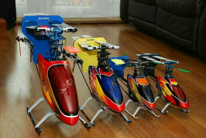

                    Revisiting my flybar days with the trusty 401.
                    sent from Samsung Galaxy S4 using Tapatalk Pro
