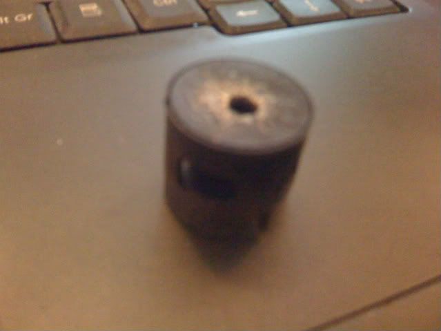

                          As you can see from my avitar I'm also a racer. I started of at 15 on two strokes then moved to a GS750 in the earlystocks. Went through supersport 600 to powerbikes. One of the best book I every brought was Tuning for speed by Phil Irvine. If you want to know anything about tuning strokers or building tuned pipes this book is a must.
                          My combat wunder is running a ASP46 with a tuned pipe and I spent a long time porting the engine and matching the exhaust. The inlets are P60 to aid the mixing the crankcase is corked and the exhaust port is polished.
                          This is my point the engine runs like a bag of S**T at anything below 3/4 throttle but above that it spins a 10x9 prop at 18.5 rpm. This is great in the plane as I only use it for speed runs but i doubt it would be of any use at all in a heli.
                          Its all very well getting loads of power out of an engine but that power has to be usable and I think that is where a lot of the seemly mismatch and "bad engineering" on these stock engines comes from.
                          One more note the more you tune an engine the shorter its life span, below is a pic of one of the 46's pistons after pre-ignition crowned the piston. Would you want this on a heli expensive heli engine after about 30 mins of running.
