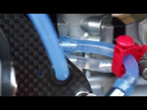

        Diaphragm changed,needles removed and carb flushed through.
        Regulator reassembled and checked for leaks and refitted.
        Idle reset at just less than 1 turn out and hover leaned to 1 1/4 turns out.
        Engine restarted out in the back garden earlier.
        Still not running right.
        Air in the fuel line still and an uneven idle.Leaned out the idle a bit more but didn't make much difference other than starving the engine of fuel and it cutting out when you open the throttle up.
        Haven't had a new check valve come yet but have a feeling that it may not help.

              Doesn't sound any different than mine tbh, the bubbles your seeing are probably being sucked in through the top of your magnet, not much fuel in that tank and the magnet isn't fully submerged and yes a rich mid could make the tail wag. What does it run like in flight?

                BTW, you need to double up the tubing on the piece your seeing the bubbles in too, its a very slack fit on the nipples.

                      we have a couple of Y.S 120's with the same problems as yours. Air between the reg and the carb but none before. This is with lines being doubled up etc.
                      I cannot see how this can be right. The reg should be supplying the carb fuel ,without air at the right pressure for the carb to work. Air bubbles going through to the carb will only upset the balance and make the engine run rough and inconsistent which is what we are seeing.
                      I am wondering if there may be a fault with some of these regs? Air is being drawn in somewhere. Does anyone know if the 120 is working off the same amount of tank pressure as the .91's?

                            Your youtube video shows the same amount of bubbles in the line as I have and YS have said this is not a issue at all.
                            • #59
                              So basically,ignore the bubbles and look for other reasons as to why your engine is not quite running properly.
