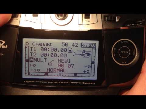

    Is this video any help?
    It covers setting up a new model along with some suggestions of things to inhibit with the reasons why.
    But if you only want the Throttle Hold info then go to 16:03 in the time line.
